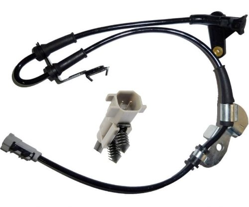

Hi got problem with the ABS, I had to brake hard the other day,the ABS kick in,Since then the ABS dosent work,I now have the ABS light and Track off lights lit on the dash, Am at a lost what to do, anyone help?
Old Dec 30, 2015 | 10:34 AM
Its usually one of the x4 wheel sensors
- but could be dirty phonic / tone rings on drive shafts
- or the magnetic pickup shown above, usually you will not see damage to the black plastic coated sensor shown below
The thing is your description of braking hard being the cause does not fit unless the securing bolt in the wheel sensor itself was loose causing the damage. You really need to find and test the particular sensor to see if it works. Do you know anyone with a diagnostic scanner capable of reading ABS on your year Chrysler ?

If you cant get the fault codes read then the first stage would be to use a multimeter to read the resistance of all four sensors. Follow the wires up from the sensor and find it's plug, disconnect it and read the resistance across the pins to the the sensor. All readings should be the same, if one is different then replace that sensor.
If all the readings are within a a few ohms of each other then take a small wire brush to the toothed rings that the abs sensors use to detect the wheel speed.
Beyond that there is not much that you can do without having the codes read.
