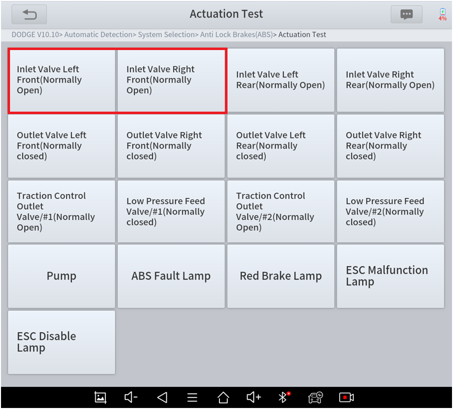

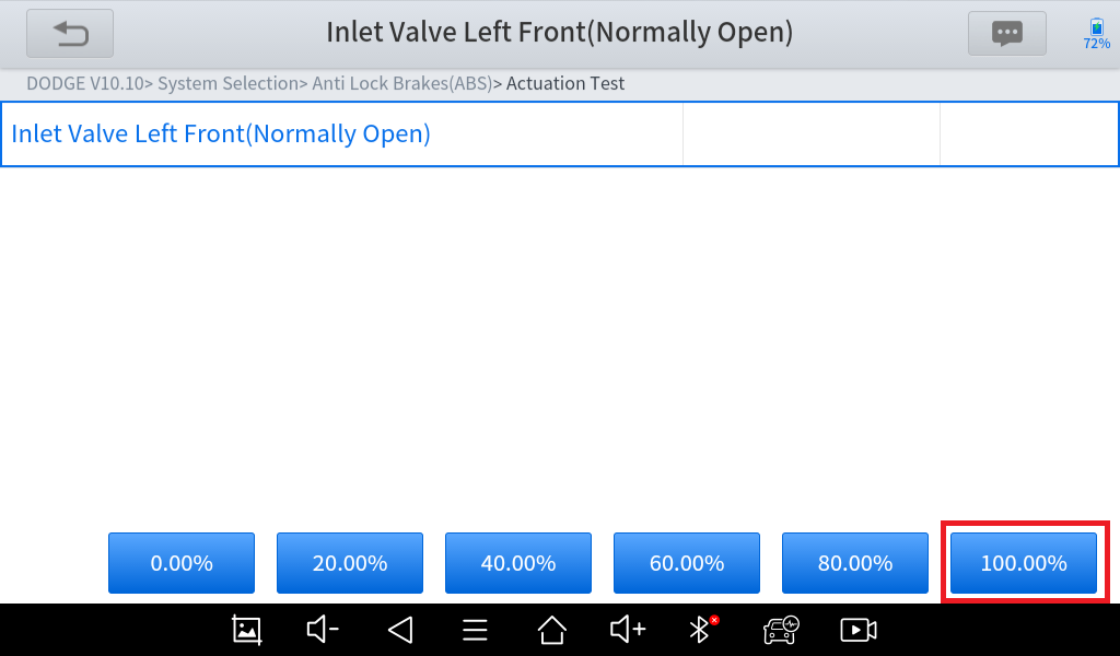

Using a scan tool (XTool D7), there is a diagnostic test within the ABS window: Inlet Valve Left Front (Normally Open) and Inlet Valve Right Front (Normally Open). Across the bottom of that screen is % activation buttons and when I select 100% on either, the left or the right, my brakes totally firm up. Selecting the rear does not fix my problem. Do you have any clue what that means? I'm really struggling to find any meaningfulreference.
I have a 2012 Dodge Grand Caravan, the brake pedal got very mushy after a panic brake incident. Immediately after which the red brake light came on. The light went off before I got home, assuming that it reset itself after pressure rebuilt. If the ABS light came on it didn’t stay on, but I’m sure it kicked in. I was due for front pads so I replaced the pads, rotors and upgraded to stainless lines, but after bleeding all 4 brakes they were still mushy. I double checked the check valve which did not seem to be leaking, but I did replace some brake vacuum line hoses that showed cracks, still no luck. I have yet to do the ABS bleed procedure, headed to do that now, but before I replace a master cylinder or ABS pump I noticed the actuation test and started playing with the scanner. Lots of tests available, and hunting and pecking my way thru it, there is an actuation test that solves the problem, but I don’t have a meaningful cross reference on what part that test points to.

I'm still curious what that activation test does and why does it solve the problem. The brakes feel very firm with the 100% selected.
Old Nov 7, 2025 | 01:08 AM
You feel the brake pedal stiffen up because the ABS pump is applying pressure to the brake fluid.
