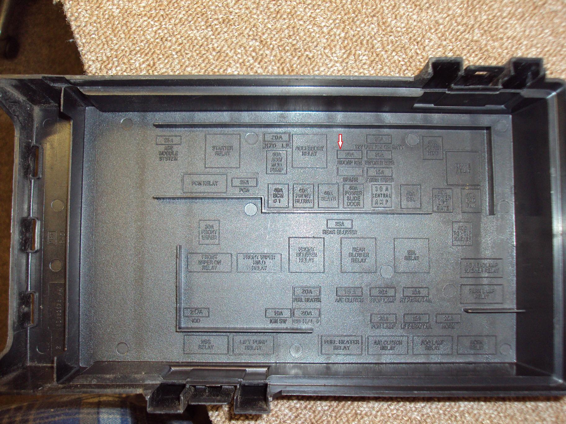

You clearly have a problem with your BCM, pulling the IOD fuse will shut down :
Remote key fob
Radio <<<<<<<<<<<<<<< always a drain and sometimes a parasitic culprit
Heater blower
Folding mirrors
Central locks
Interior lights when the key is in the ignition
Power seat
1st crude test - (1) what is the draw before you pull the IOD fuse, - (2) what is the draw after you pull the IOD fuse, it should come down at least a third !
2nd crude test put everything back the way it was and then pull the 20A fuse marked in red called RDO/IP before you park up for the night. Next morning put the RDO/IP back in does it start up ok ?

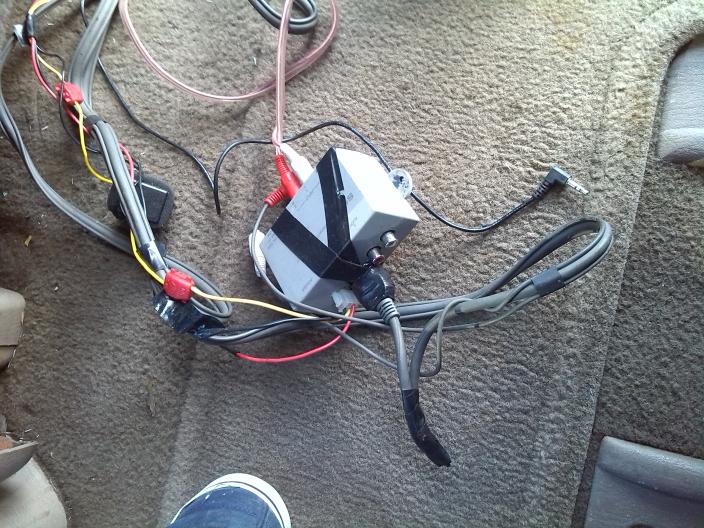

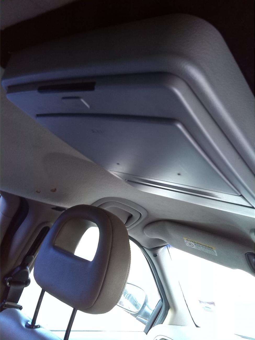

Here is the dvd monitor and the wiring on the floor. Very shabbily done and will be getting rid of it soon
You need to find out where the live feed to the overhead video is coming from, this is easier to do before you pull it out.
In #33 you said """ the radio stays on and I have to manually switch it off """, do you mean :
- the radio stays on for a couple of minutes, and then automatically switches itself off, or ;
- do you mean the radio never switches itself off .... ever .... unless you switch it of manually
