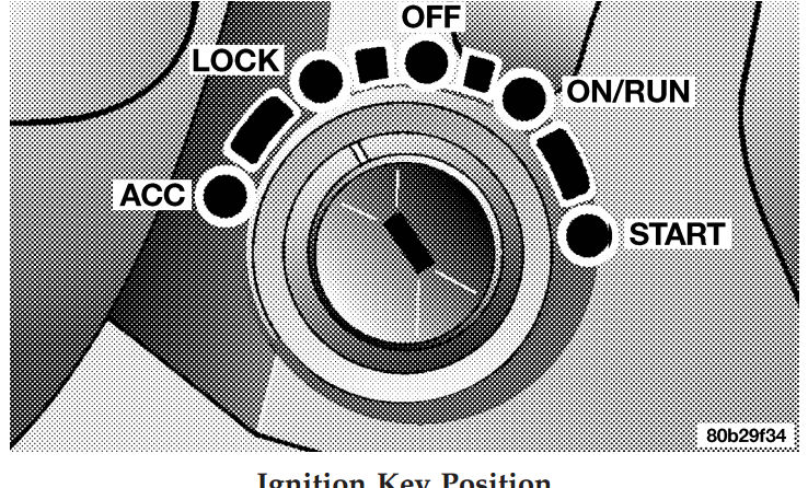

Just a thin smear the same as you would if you wiped a thin smear on your child's lip /cold sore. Of more interest is why did you choose to replace the battery in that 1st instance, what was it that was 'previousy' giving you problems that made you decide to splash out all that wonka on a new spiral ? Are you sure you were not having starting / running problems in the first place !
Are you sure you are switching the car car off properly at the LOCK position and not accidentally leaving it in the ACC position. There is a noticeably raised piece of plastic at the LOCK position that you can feel with your finger [see the twin white lines in the picture that diametrically correspond with the key shape below] that is designed to indicate the point at which to pull out the key so that all the accessories are switched off.

I am still new to the car and didnt realise I had to push that button after switching ignition off. I found out the hard way and thats how original battery died.
