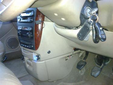

Guys I just noticed this switch for the first time. Any idea what it could be? Got to be aftermarket as it doesnt appear in the manual. Its on side of radio next to steering on pic near the blue usb thingy

Its with great embarasment that i report the battery drain issue is now resolved/fixed. It was that bloody Sony overhead monitor causing it
Now i am very hesitant to put in a new one in case it causes same problem. Surely the new ones are easier to intall. The Sony one looked anient
