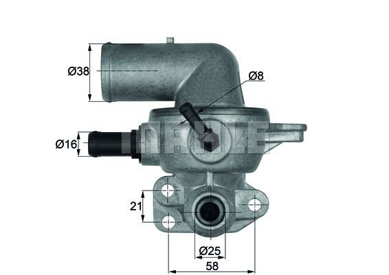

It used to be just a little warm thanx to the auxiliary heater before i did the Andy mod, now it is as it should be, you can drive in t-shirt and shorts in mid winter.
The heat sensor is still in place fitted onto the old thermostat, i didn't change it bcz the relatively reasonable priced ones don't have a place to fit it onto.
I have pictures:
The aftermarket cheap one
the "original one"
as you can see they look the same, they fit perfectly in place but the cheap version doesn't have a fitting for the temperature sensor.
