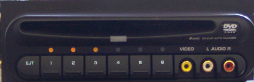

I'm trying to fix a problem with my DVD player which started after fitting a new battery. It's annoying because the same fault occured with my last Voyager after fitting a new battery to that too.
I think it's a common fault: 6 LED's flash in cycles, 3 on left then 3 on right. Can't play any discs nor will it eject any discs.
I've partly dismantled the unit but I need to apply power to it while it's on the work bench, so that I might be able to see what the problem is (Possibly mechanical).
So does anybody know which of the pins on the multi-pin plugs supply 12v to the unit? I've tried testing with a meter but the holes in the sockets are too small to access.
This is the model:

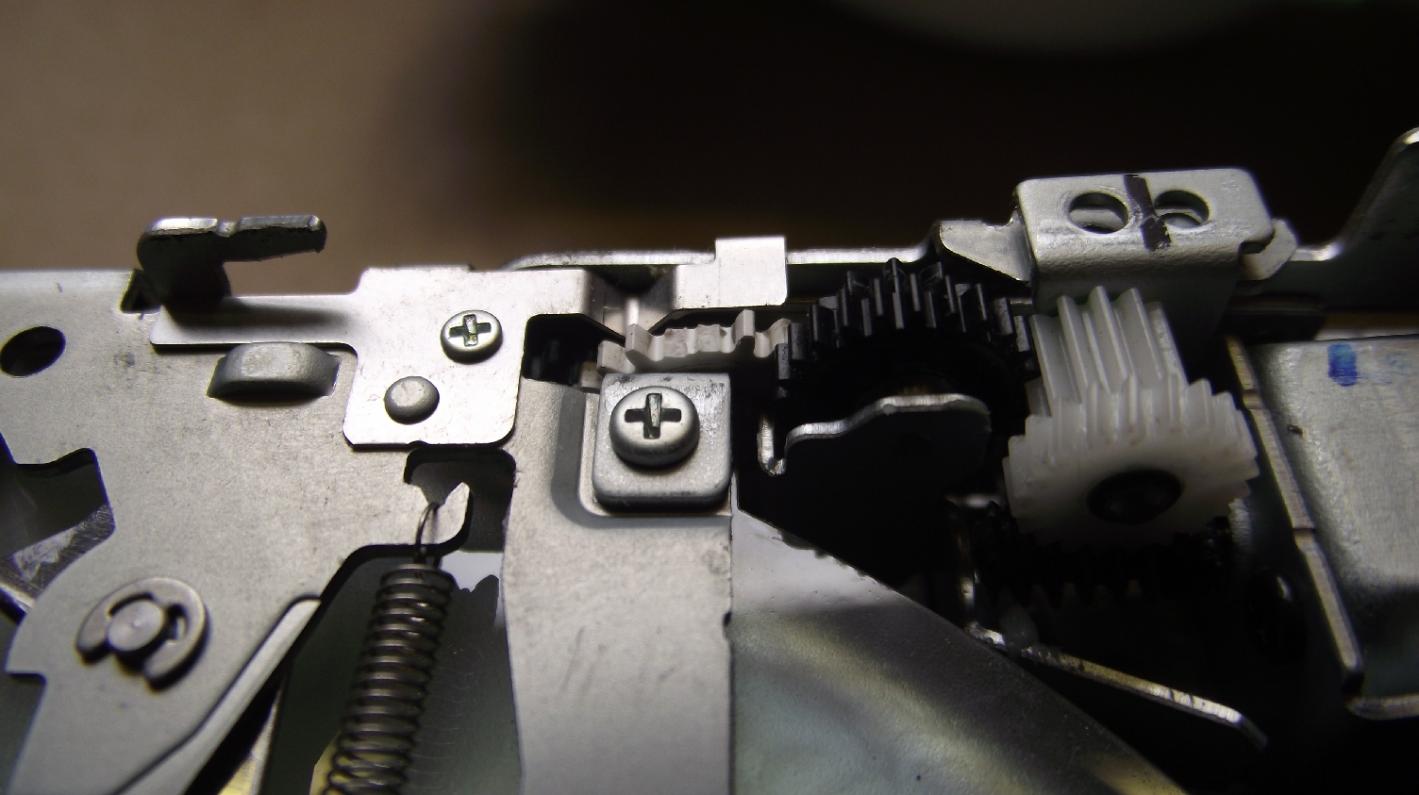

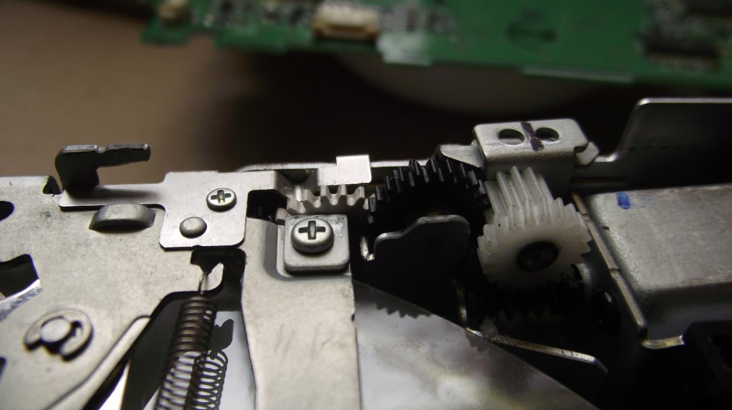

Unfortunately I discovered that my DVD autochanger is beyond economical repair. Two of the teeth have been stripped off one of the nylon gears. I suspect when re-connecting the battery the autochanger can try to eject multiple discs, this results in the mechanism jamming and stripping teeth from the gears.
It's probably a good tip for all Voyager owners fitted with autochangers to always eject the discs before disconnecting the battery.

I would need to dismantle a lot of the intricate ejection mechanism to get to the damaged gear and to be honest, I doubt that I could re-assemble it all correctly.
