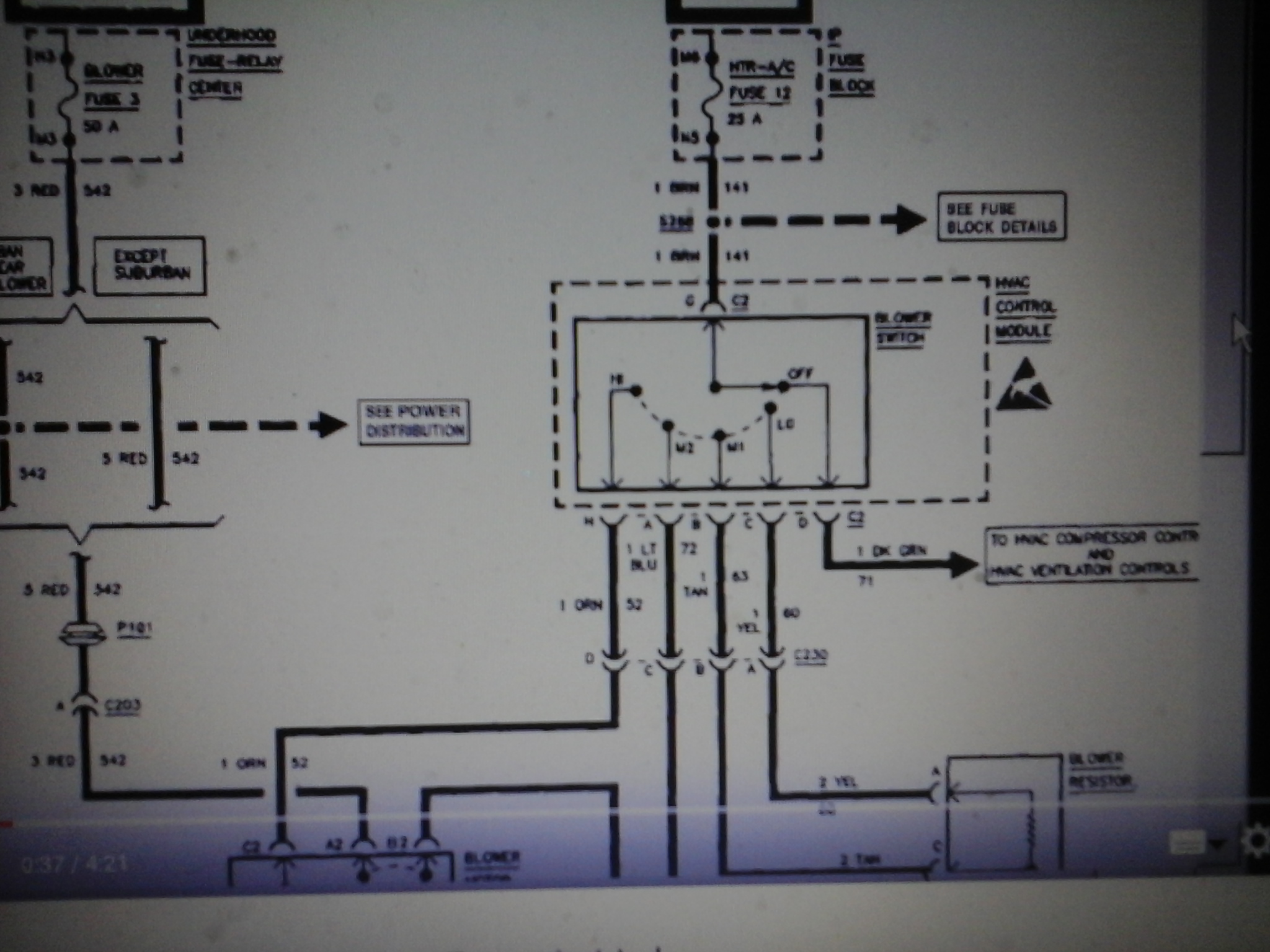

Right, heater resistor module replaced to stop fan running all the time as soon as ignition turned on. Didn't think it was the resistor as the resistor is usually the fault when blower only runs in high position and not at all in lower speeds.
When IPM checked the relay was found ok and not welded contacts.
The fan relay connectors in IPM were however live and powering the relay coil all the time even with ignition key out. (Key must initiate the fan earth or summit).
Resistor (module) has 4 connections as for internal resistor of course but also another 2 connections which by looks of it control the power and make it a control module if you see what I mean.
I'll need to watch that vid on you tube again headed blower fan runs all the time, but it's schematic only shows a 4 connector resistor. See pics for this.
