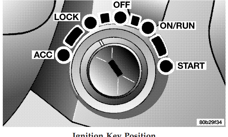

Hi again,
OK, after a bit of research i've discovered how to do the key dance which gives the engine fault code.
ON-OFF-ON-OFF-ON
However, it won't work
Has anyone got any tips or advice how to achieve a correct key dance?
I am turning from the complete OFF position to the first click, i.e. when the odometer only comes on?? Is that correct or do I need to turn until all the lights come on (p.s. ive done that as well but it doesn't work either..)

The key is the below.
The dance is the timing [knack] between moves in milliseconds between the OFF and ON position. Brain in gear, patience, it works in milliseconds, practice. NOTE that the OFF is one clockwise from the LOCK position and the LOCK position is the only position from which you can withdraw or insert the key into the barrel.
That was great advice QinteQ, I got it second time..!
It's flashing P1130 after successfully doing the Key Dance...
When I first did it, there were a few other codes that showed after P1130, but I hadnt taken a pen, so when I went back with a pen and did it again only P1130 flashed...
P1130 keeps flashing until I drop the key back to 'OFF' position when it then says 'Done'.
