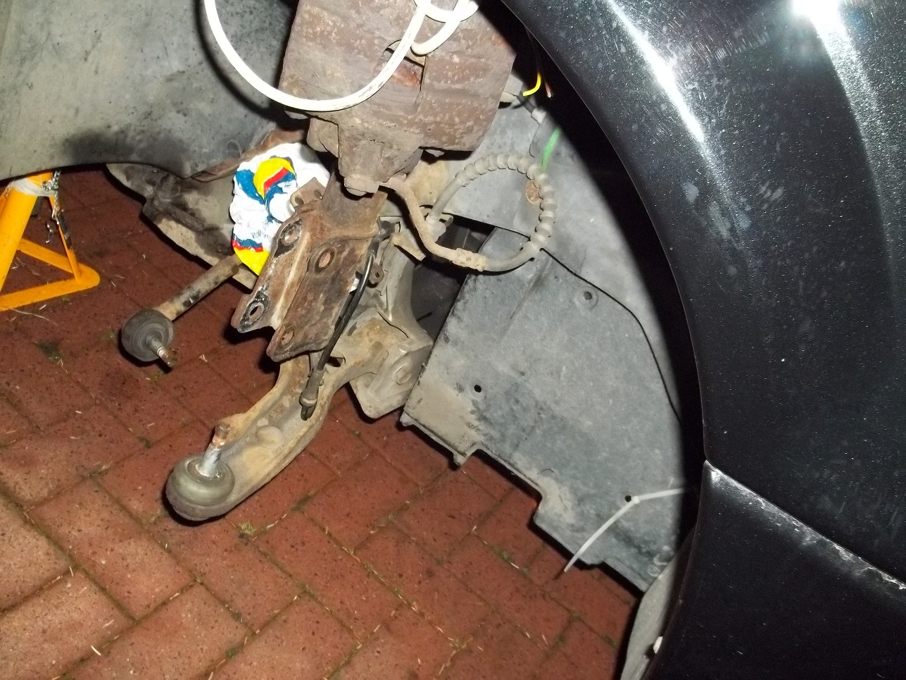

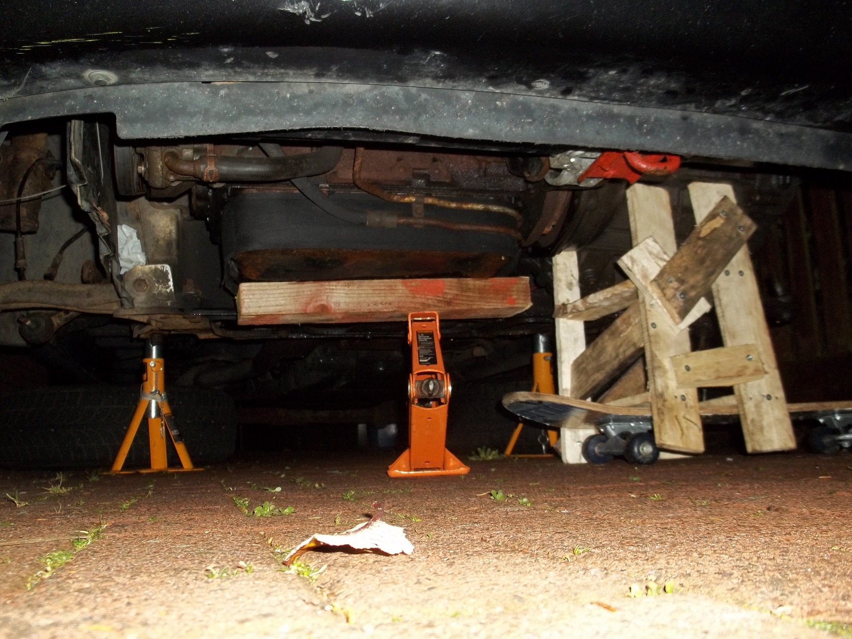

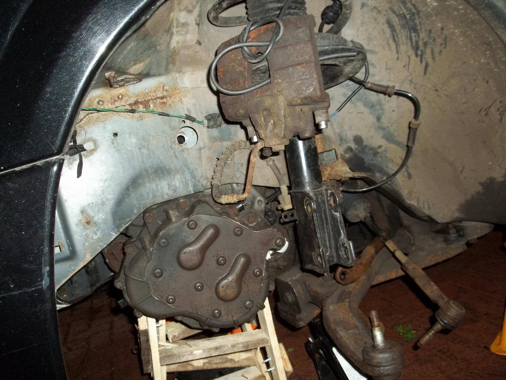

Suspension arms and inner steering ends still to remove. transmission open ,just to take out. Got too dark for today.

I like your gearbox cradle, you've been working in Bounty Bobs gold mine haven't you.
Think I'd prefer blocks of wood under that sump incase jack goes wobbly. You can always take them out now and again with use of jack.
Further than that, keep the pictures coming...

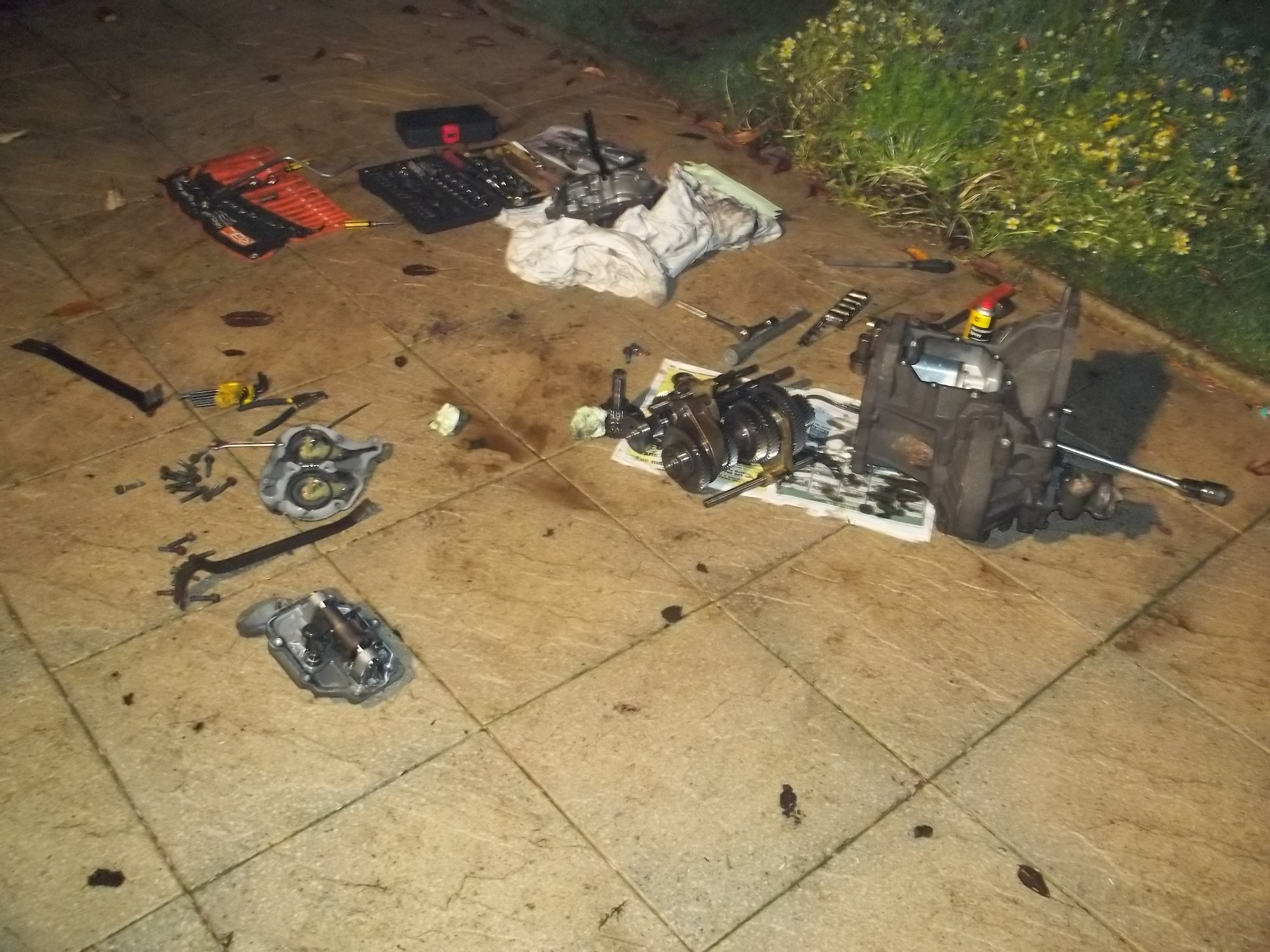

Slight improvement today. New input shaft bearing is fitted. Wasnt that easy i thought it will be. Now box all together again. But who knows how many gears i have now.
