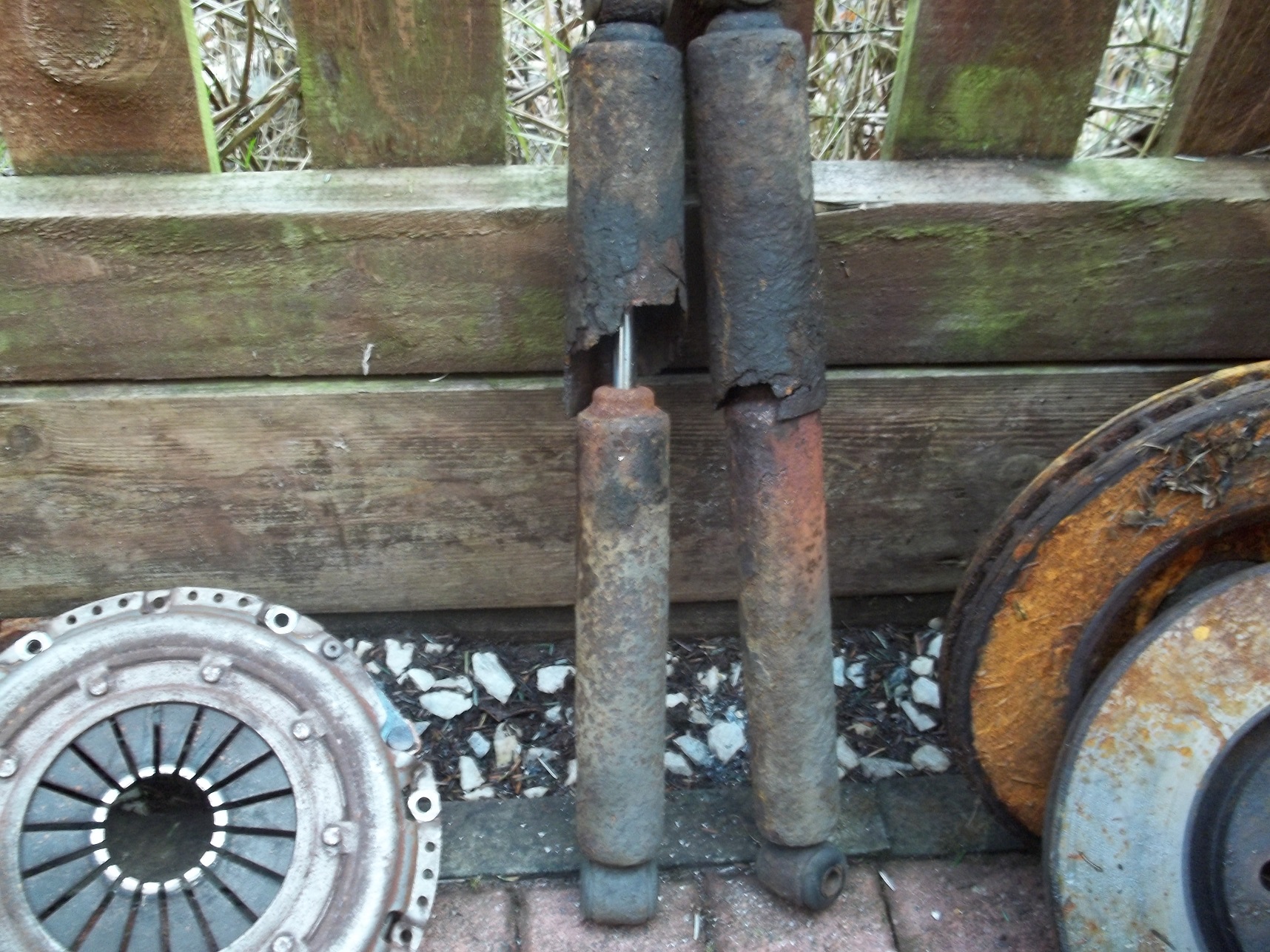

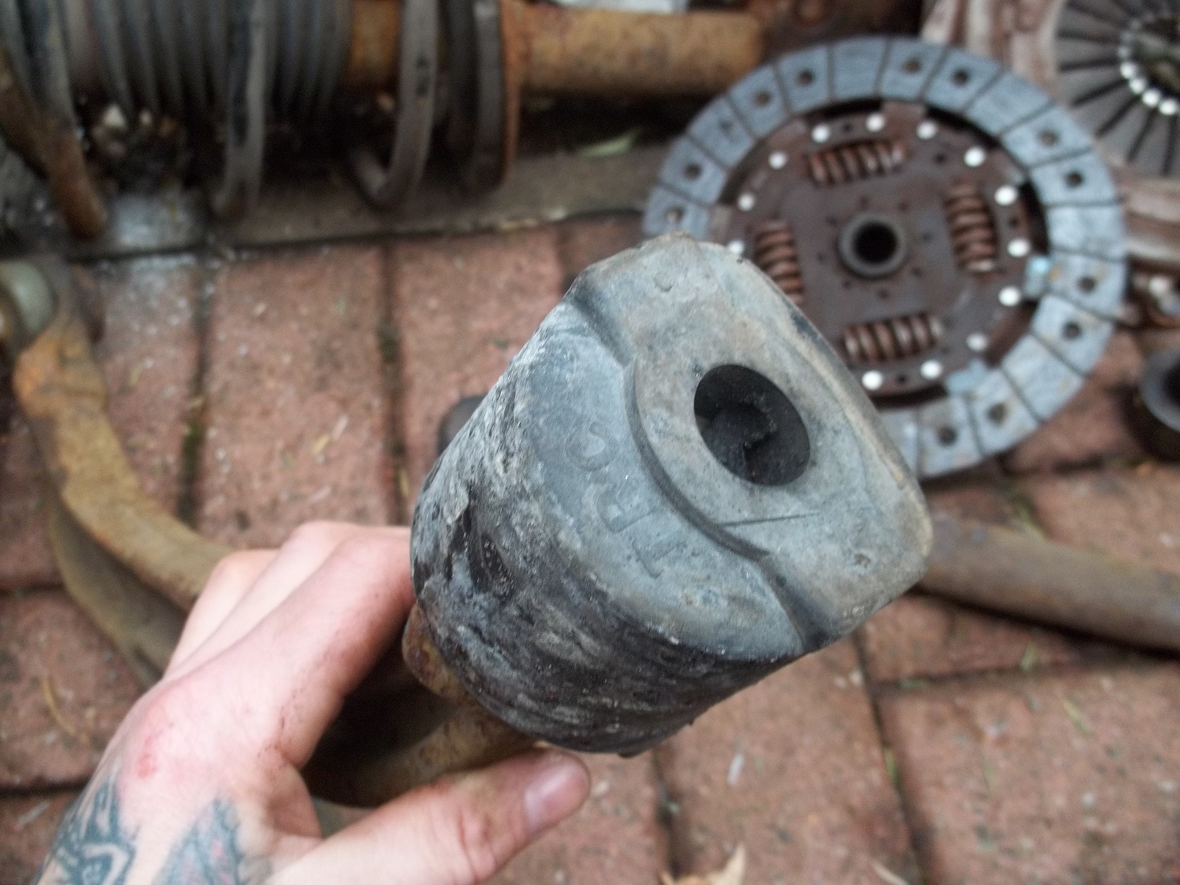

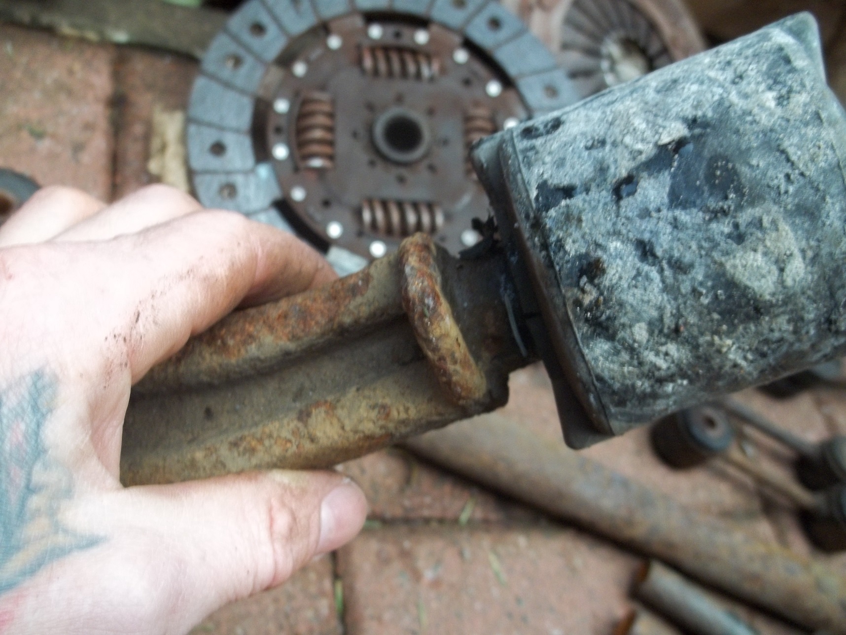

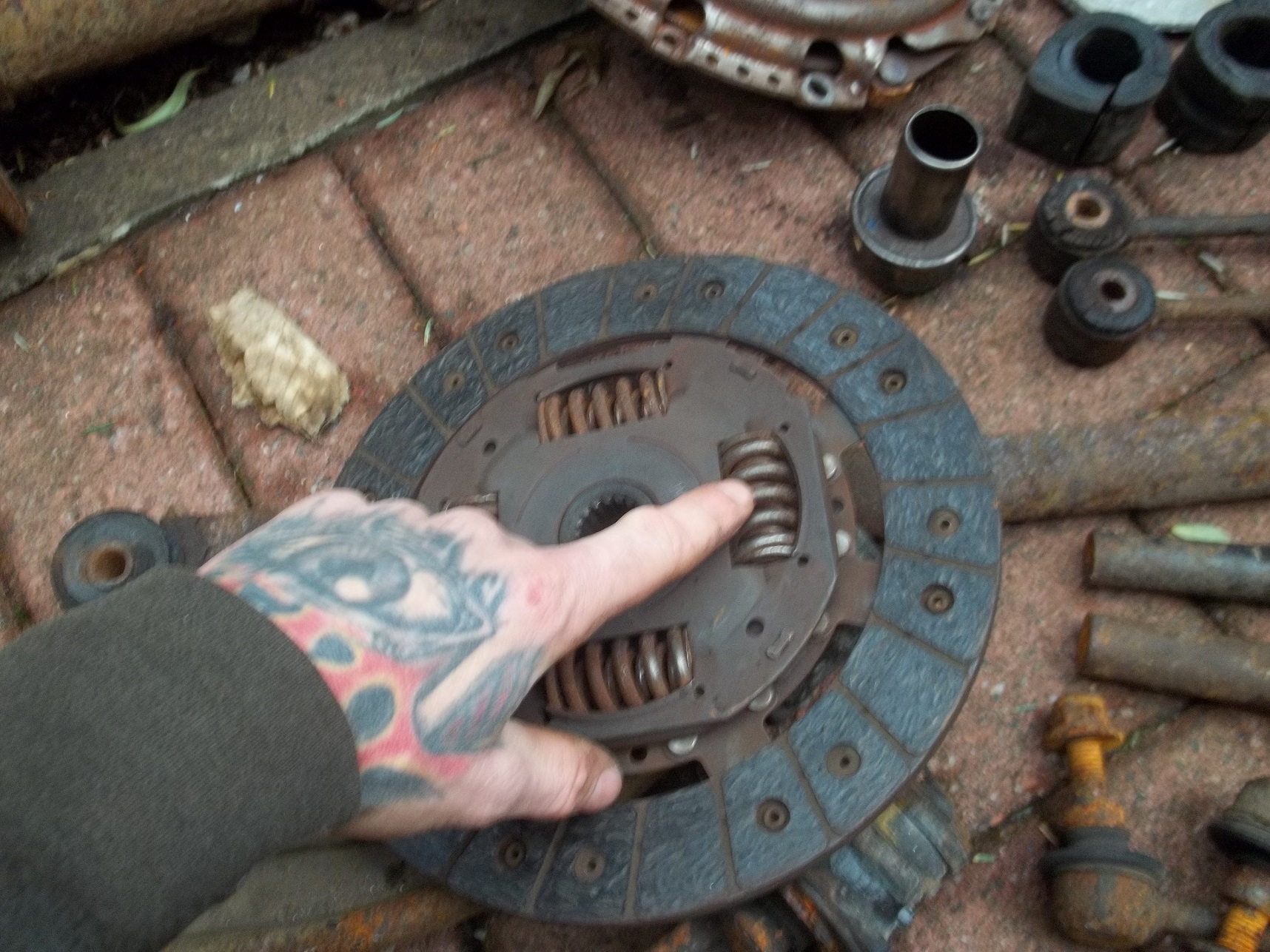

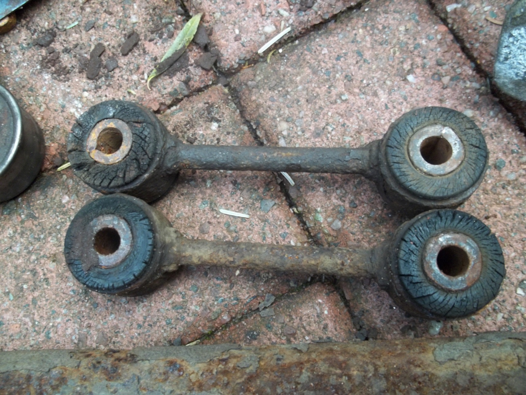

Here are parts that came off. One suspension arm end bushing seems to slip off, shocks so rusted also rear tracking rod. Rear brake discs and front strut from earlier this year. Front sway bar bushings so worn,,never seen these that bad. And rattle noise from transmission was caused by loose springs on clutch disc. Yeah,,what can i say.
