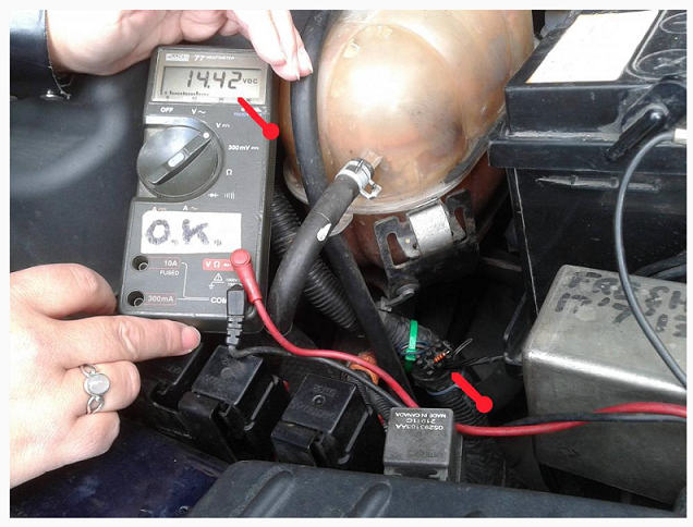

Results for two trials, one of 10 miles, one of 35:--
Charge voltage remained at between 14.3volt and 14.5volt all the time. There was no reverting to float voltage as with the unmodded operation. (This could change over a long journey).
The original charge voltages matched exactly those for a jelly battery (13.9 after cranking and start, reverting to float charge of 13.5volt after a few mins).
There were no burning smells from the alternator nor did it seem hotter than the rest of the engine.
If a user wants to revert to original charging system, just wire a simple switch across the 33K0 resistor. Current here is tiny, any small switch will do.
This new charging voltage used to be used for wet batteries, and I do think wet batteries are far and away better value for money than the later AGM and jelly types.
I've looked into the gassing of batteries, which is important with AGMs , I can't see this will be a problem, esp. with calcium-loaded types. I take the opinions of some who have worked in lead-acid battery manufacture, because there's much in the way of wrong ideas out there. One website actually said the newer batteries were suitable for the "stop-start" cars. He obviously was waffling, because that's the very problem that's caused starter batteries to fail after as little as 3 months on these cars.

- informative post Leedsman
- good work
- I've only got 1Watters at 33KO and no connector blocks left
BTW nice reliable meter I've got the 177 of the same - but only because it was given to me free of charge

Old Aug 31, 2013 | 04:02 PM
Leedsman's Avatar
Joined: Jul 2013
Posts: 885
Default Charge mod. picture
Hopefully this will show the picture.
Leedsman.
Attached Thumbnails Of interest to those getting flat batteries.-charge-mod-1.jpg
