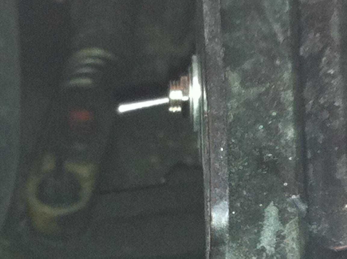

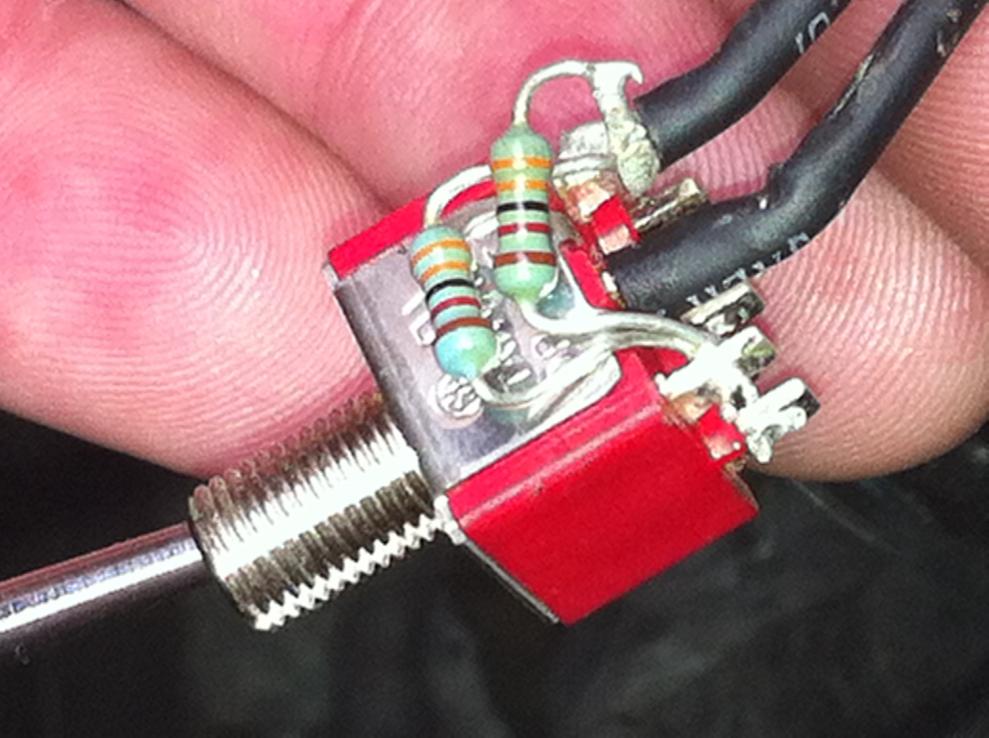

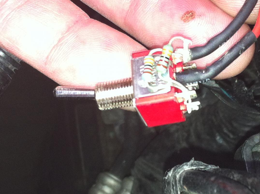

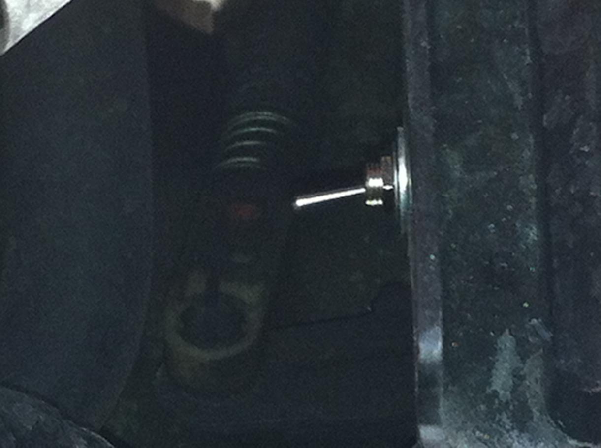

Hi QinteQ/leedsman
Just found the photos of the 3 way switch, sorry took so long.
Switch is from Maplins, 2 or 3 pounds I think, its an "FH05F".
I have left it on the high charge for last couple of months and don't think its overcharging. I think its under capacity because it was undercharged on the vehicle for 18 months, might try your trick of trickle charging for a couple of weeks.
Attached Thumbnails Of interest to those getting flat batteries.-img_1398.jpg   Of interest to those getting flat batteries.-img_1399.jpg   Of interest to those getting flat batteries.-img_1400.jpg   Of interest to those getting flat batteries.-img_1401.jpg
