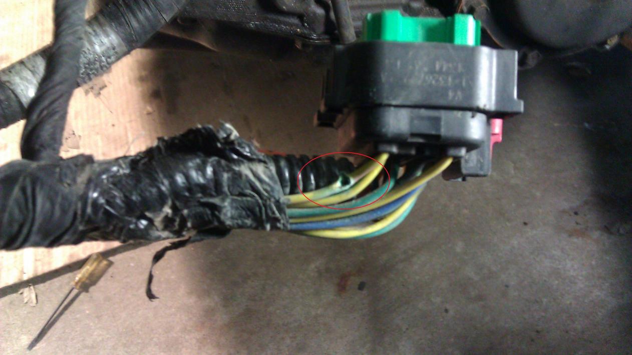

In case anyone was curious to know what the real problem was, I just had to sleep on it overnight to figure it out.
Turns out in a hast to figure it out I had got caught in the inverted logic of the L/R pressure switch. This morning I realized what I had done and that 12V was really off, duh. The fluid diagrams did match what my tranny was doing. I think I even wrote it wrong in my previous explanation. I said it correctly when explaining how the switch logic worked, but when I was monitoring it on the car I didn't think hard enough and when I saw it go from 0V to 12V I assumed that was pressure and forgot about the reverse logic.
Once I got regrouped I realized it had to be a connection between the solenoid module and the TCM.
Didn't take long to find the opened wire (see pic). The wire was on the outside of the bundle and rubbed against an inside corner of the back cover of the connector. From the looks of the amount of corrosion when I stripped it back it must have been that way for some time. I just bought the vehicle and can't believe what some people just live with.
