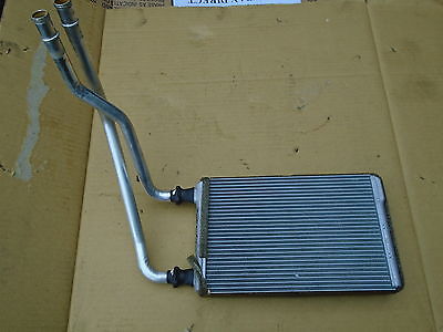

Those two silver pipes I believe are the cooling system feed to the cabin heater matrix (radiator).
This is what it looks like:
Which does look similar to the component in the video. I'll have to dig the repair manuals out and check, I've not got them handy right now.
Oh, but I've just found a youtube video on replacing the heater matrix and sure enough it's that spot there:
I wonder if there is an airlock in the system. Have you recently had any cooling problems, lack of coolant, radiator change, etc?

Thanks for the feedback and the video link. It does indeed look like those pipes go to the heater core.
No recent work on the cooling system, but my wife said the van overheated the other day. It's not a very common problem and the vehicle has generally been just great. It resolved itself and I didn't think much about it, especially since the sputtering noise predates that issue...could very well be related.
Airlock in the cooling system? Hmm. I don't know exactly what that is, but it could be something. It's a kind of sputtering / water-like noise, but as the video shows (poor audio) it's loud enough that it makes a kind of clunk. Up until this point, it has sounded more like water. It's periodic and hard to catch a recording of it.
