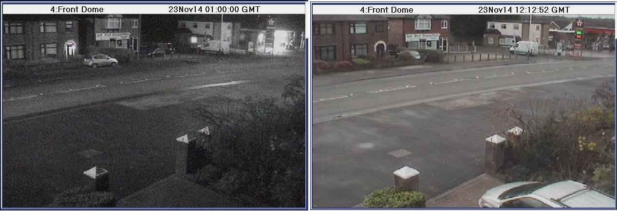

Originally Posted by Leedsman
Re. security cameras:
I've wondered how good the lighting is on those I/R cameras with a ring of I/R LEDs around the lens.
That type of IR lighting can be acceptable on the better quality cameras and manufacturers often claim ranges in excess of 15 metres but in reality they fall short of 10 metres.
Professional CCTV installers will fit units like this: Raytec Raymax 25 Illuminator 120° 850-940nm PoE
This is the baby of the family offering a range of up to 30 metres at a price of £180 each.
Apart from the short range, the other problem with IR when it's integrated around the lens is reflections off adjacent structures and spiders webs. This can be so severe as to render the camera useless during the hours of darkness.
A good alternative to providing additional lighting is to use a Day/Night camera. This automatically switches from colour to monochrome and opens the iris to let more light onto the sensor. The results can be quite impressive in areas where there is little ambient light available.
This is an example of a Day/Night camera. The image taken at 01:00 hours is just using the ambient lighting in the area.
