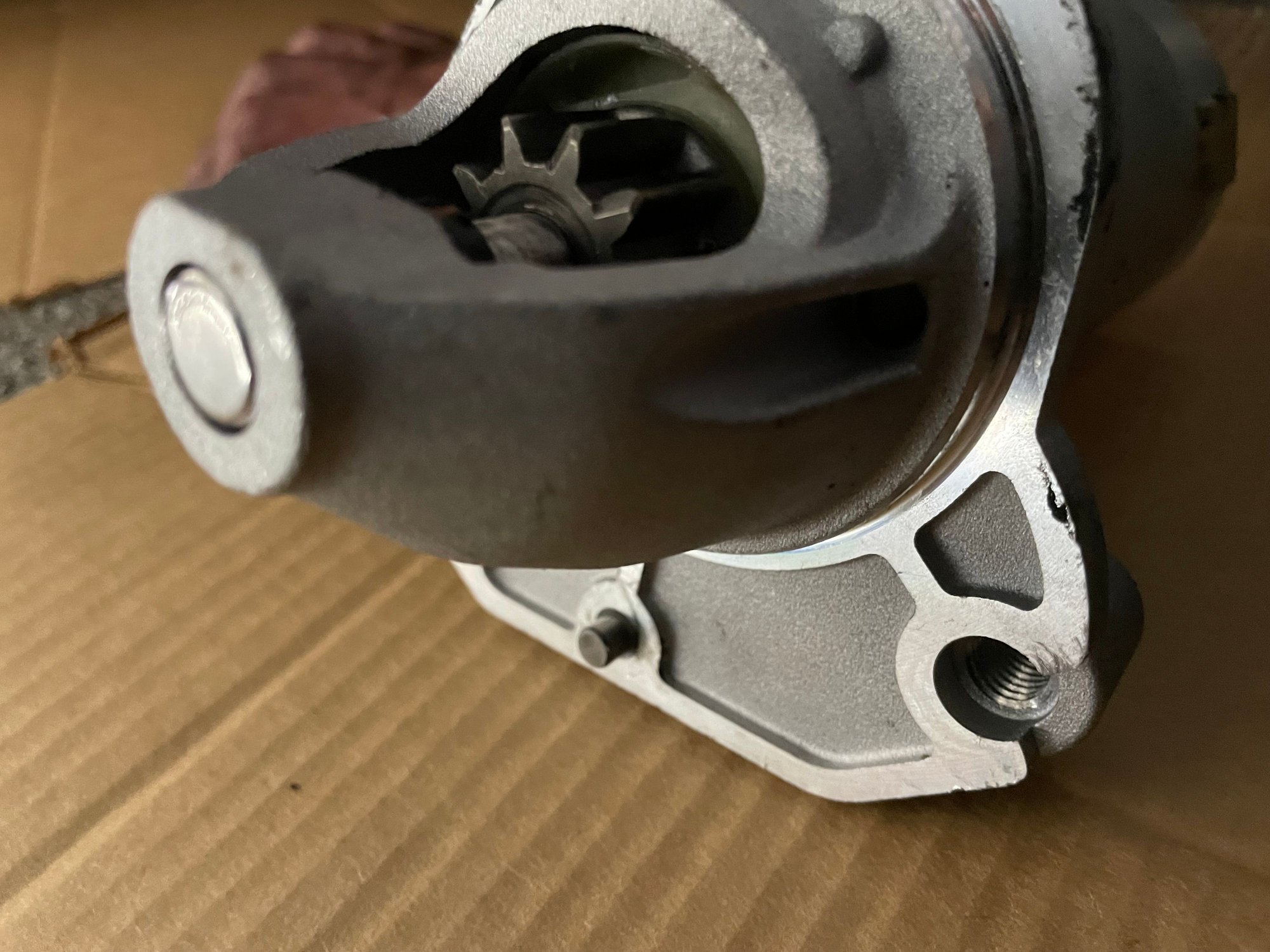

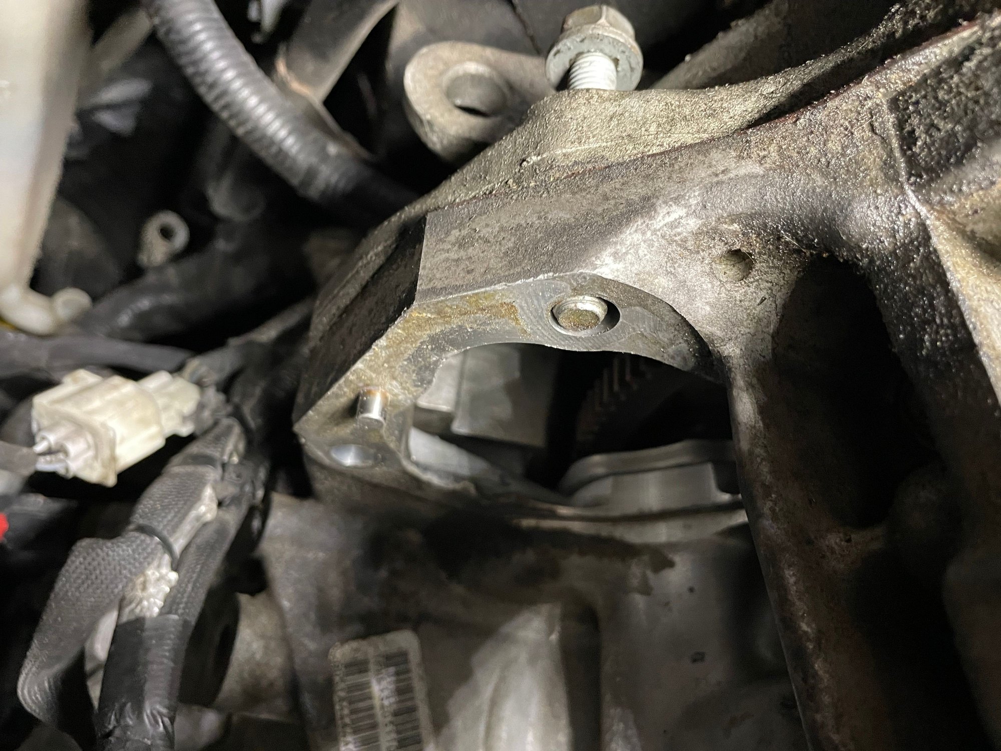

Any help getting this out?
The pin between those bolt holes should have come out with the starter
Here is my new starter with pin
most of the ideas I’ve seen online don’t apply to my town and country because the starter location in my vehicle is such a bear to get to. I’ve tried vise grips and a gentle hammering. As you can see that pin is supposed to stay in the starter.
Old Sep 5, 2023 | 11:50 AM
Have you tried heating the area on the casting with vice grips on the pin?
Old Sep 6, 2023 | 09:44 PM
Rust penetrant heat or remove the pin from the new starter
