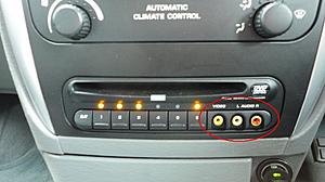

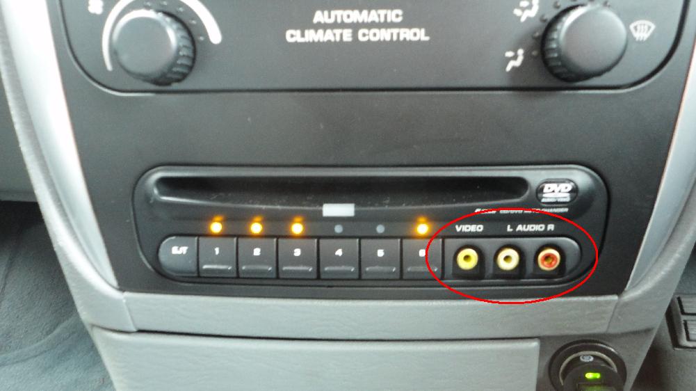

So you're saying that even though the changer does not work (because some cds were stuck inside) audio inputs in DVD still working and I can connect e.g my phone?
Old Oct 3, 2017 | 12:15 PM

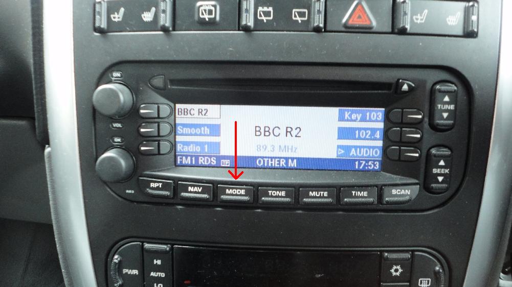

Yes, the audio and video inputs on the front of the unit will still work.
After connecting an audio source, you may need to use the Mode button to select that input.
