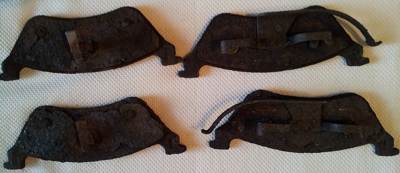

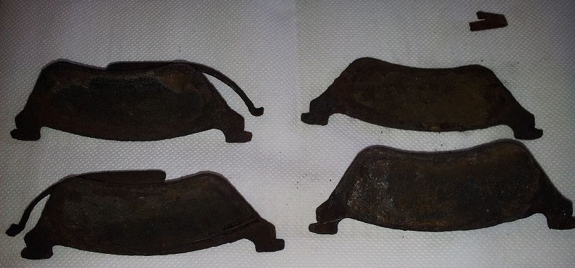

In #1 of this thread I said """I suspect those pistons have been in a stuck all the way out position for many many years"" and in #3 I said """I am embarrassed at what I found but what I did find suggests that unless we are prepared to do an apparently unnecessary complete strip of the whole calliper each GV owner might be blithely running around with seriously compromised brakes""" Here are the rear's then front's of my rear disk pads so we can all learn from my mistake.

The pistons worked well enough to pass the VOSA test and retracted just enough microns not to bind. When after unreasonable force was used to put the pistons back in enough to fit new pads the piston always locked on like the taxman's death grip and would not release under any circumstances. Clearly the pistons were semi-seized on and had been for years and ditto the metal on the footwear was old and thin enough to have been eaten through by years of neglect and the pad material was lace thin where any existed at all..
NOTE : The broken cornet clip from the one of the inners on the TRHS, it was so thin it sheared off when I just lightly touched it.
A lesson to me [per Leedsmans comments a few months ago] check em yourself, rely on no one, 15 minutes a corner and strip the calliper completely - only when you turn it upside down and eyeball it yourself can you truly say .............. I've checked ................ they're ok ................ put the grand-kids in luv !

QinteQ, the rears look like something they dug up from an old Roman settlement on the Time Team programme

Agreed Al, I will confess to being more than embarrassed, I'm light~of~foot and I can only assume that the previous owner [deliveries & collections of antiques] had an equally insubstantial braking foot style to have had the metal rot over enough salt winters. So many in fact that the glazed friction material nearly outlasted the metal. I just thought I'd overcome my shame and post it as a warning [aka Leedsmans handbrake] to the group.
