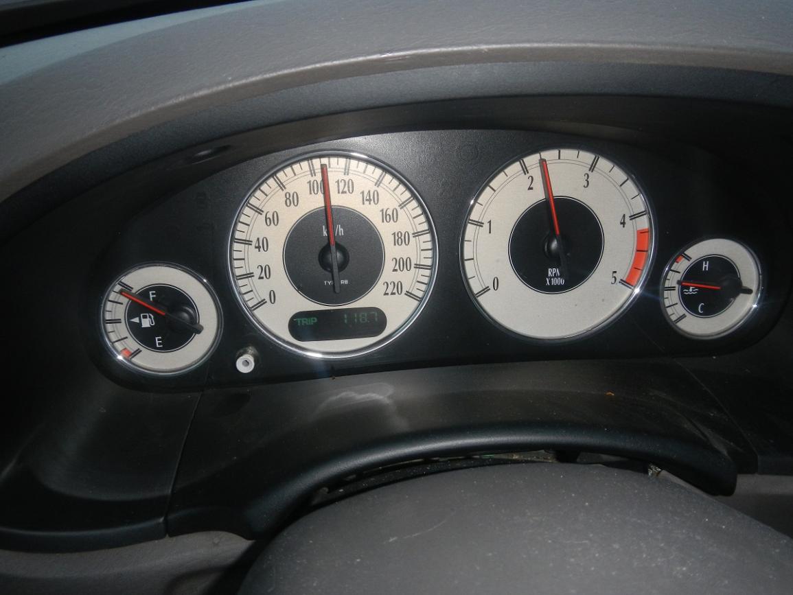

Ok the thermostat is in the tube and it works great now
At first the temp would not rise quick or high enough so I also blocked the radiator airflow with a piece of canvas (on the inside of the grille)
Now it runs great and it even gets warm enough for the radiator fan to kick in after an hour drive during 1-2Celsius (maybe I should reduce the size of the canvas a little)
I followed all advise given and it worked great (Thx Leedsman for the idea)

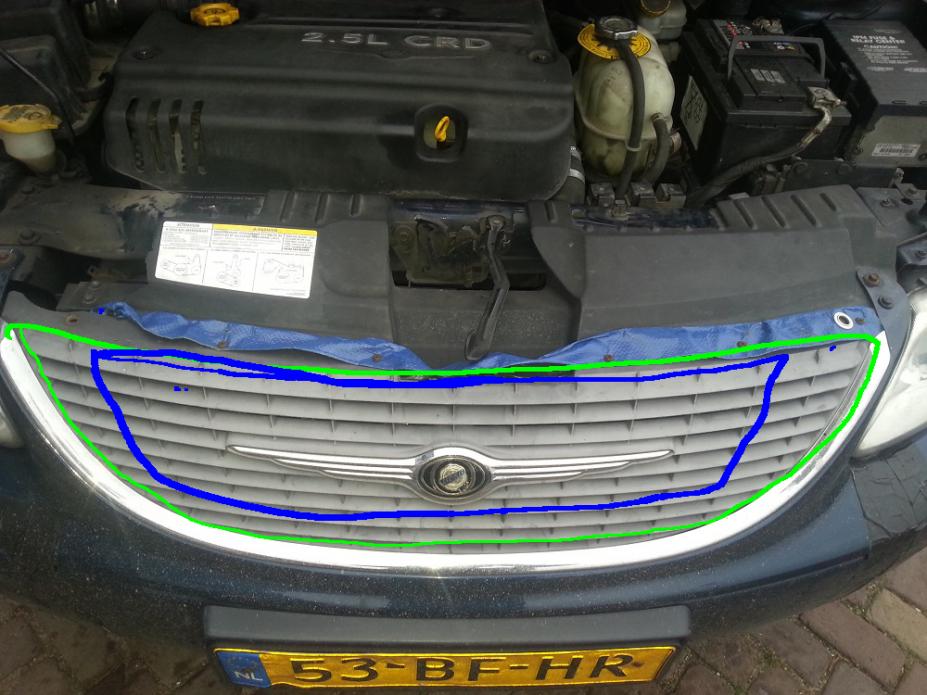

Today I made a 450km highway trip with an outside temperature of 0-3 degrees Celsius. The first half of the trip the airflow to my radiotor was blocked according to the Green lines in the picture.
I found that the temperature got too high, even on the highway because the fan of the forced cooling kicked in every 10 minutes to lower the temperature back to halfway the meter. Anyway that was living proof the new thermostat worked as designed!
When I arrived at my destination I cut some off the canvas at the sides and at the bottom according to the Blue lines and drove back several hundred kilometres.
Now the temperature was behaving perfectly! The needle climbed a little above halfway but did not rise to the height where the fan needs to kick in.
I say I keep it there till nxt summer
I think I saved like €200 to €300,- using the alternative thermostat trick. Money I don't even have at this moment as starting small business owner.. I already need to use my last resources to pay for the new crankcase seal I need..

Yes, I can see what you've done -- maybe the 2.5 diesel has a smaller rad. than the 2.8?
And maybe your air blockage was right up against the rad. itself, rather than the front grill?
Anyhow, your feet will be warm now, and you'll be using less fuel plus a heavier wallet.
