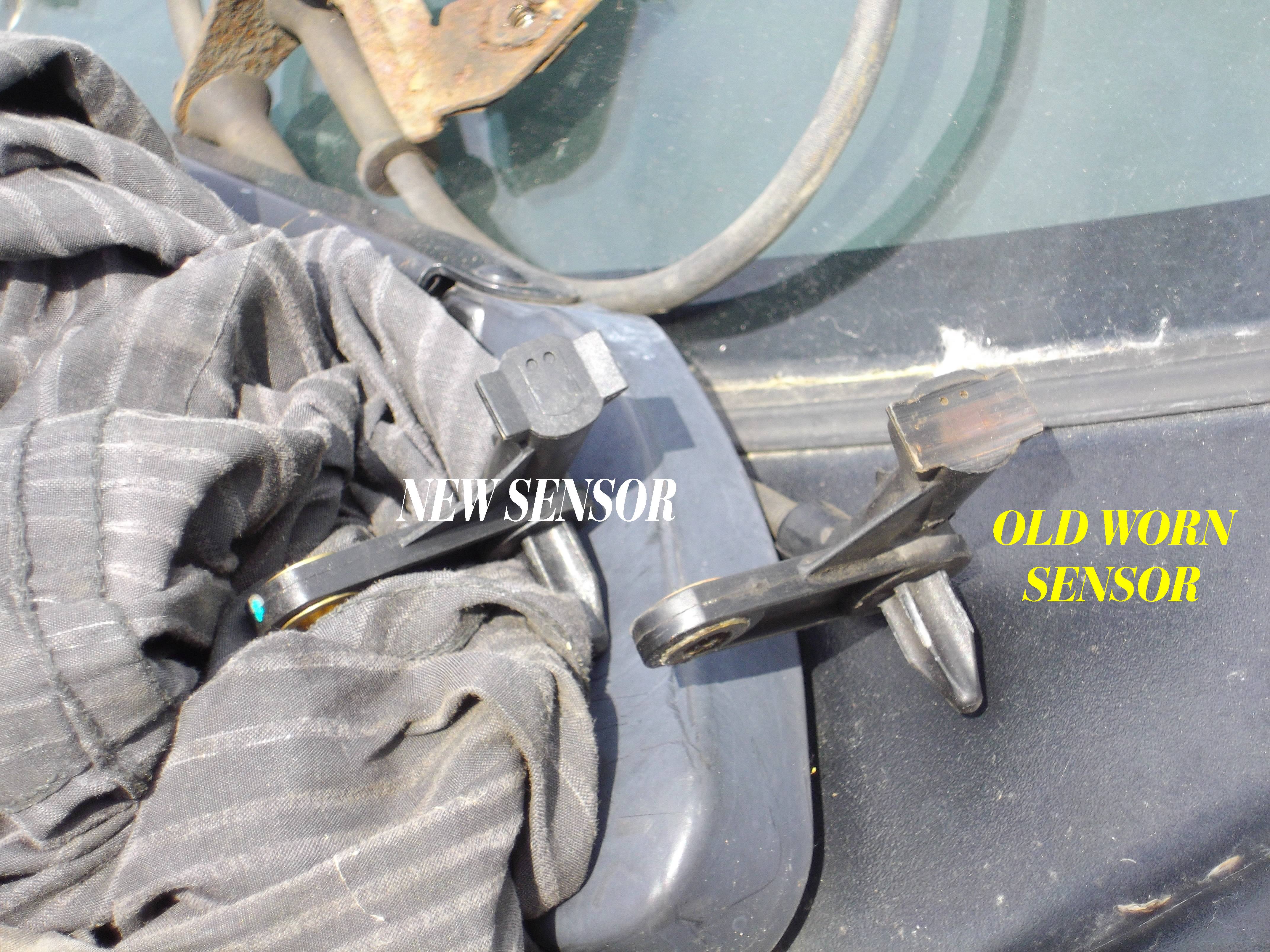

Having a little (difficult) ABS experience with the complexity of a traction-control which is inevitably part of an ABS system, probably the best way to tackle any fault in these systems is to get a scanner reading immediate. This is one area where a proper scanner can identify what malfunctions there are and if there are more than one. Of course wheel sensors and tone wheels are top of the list for failure/being out of spec.,(because of the conditions under which they work), but without the interrogation of a scanner, it's all going to be guesswork. So it might be best to stump up some cash for a reading. You should check if the scanning garage has the necessary software to do the job

When a GV gets old, all the tone wheels are going to get rusty to some degree or other, some of the sensors could be abraided on their surface due to rust/general crud getting into the gap between tone wheel and sensor which is only in the order of 5 thou'. The magnet in the sensor is important that it be the right strength, otherwise the small output of only a few millivolts will be degraded and the "shaping" circuit* in the micro's board won't work properly to produce reliable square waves for the micro to assess the relative frequency of the wheel sensors, which is of course exactly proportional to speed. The program will then judge if any differential in wheel sensor frequency is " reasonable" (such as turning a corner) or not. Unf. the system doesn't work at all well on snow, ice or gravel, and could be said to be pointless in these conditions. Having said that, some maker somewhere might have come up with a system that WILL work under those conditions. Also, I would have thought that having the tone wheel cogs on the OUTER circumference was the worst place to have them, as centrifugal force will propel any rust/foreign matter straight into the small gap between it and the sensor. Much better to have the cogs on the SIDE of the tone wheel, the crud is then propelled at right angles to the gap.
Finally, these ABS sytems will be time consuming to fix, you might well have to change all four sensors and all four tone wheels on an older GV. All very annoying.
*Some systems have the pulse-squaring op-amp in the sensor itself. This will need a three-wire sensor. Otherwise a two-wire will only have a magneto diode in it.
Leedsman.

I have sorted out the ABS issue. I changed the front and rear Abs sensors on passenger side. I can swith ON and Off the TRAC.

I replaced the missing ABS LED and it's sorted everything. (plus two abs sensors). Pretty much happy with the results.
I had a issues with rear sensor. I have Stow and go seats and you must buy specially designed for the Stow and go otherwise the connector will be different. Front ones all are the same.
