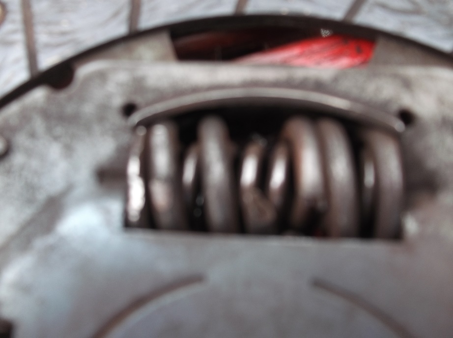

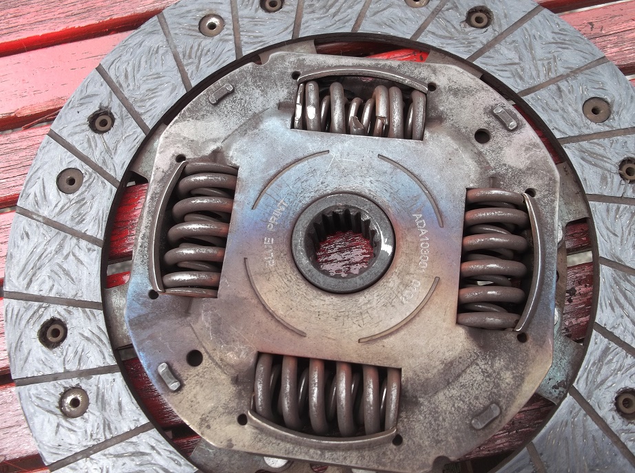

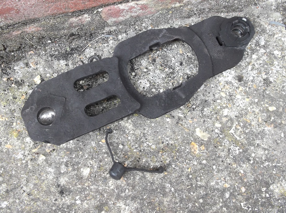

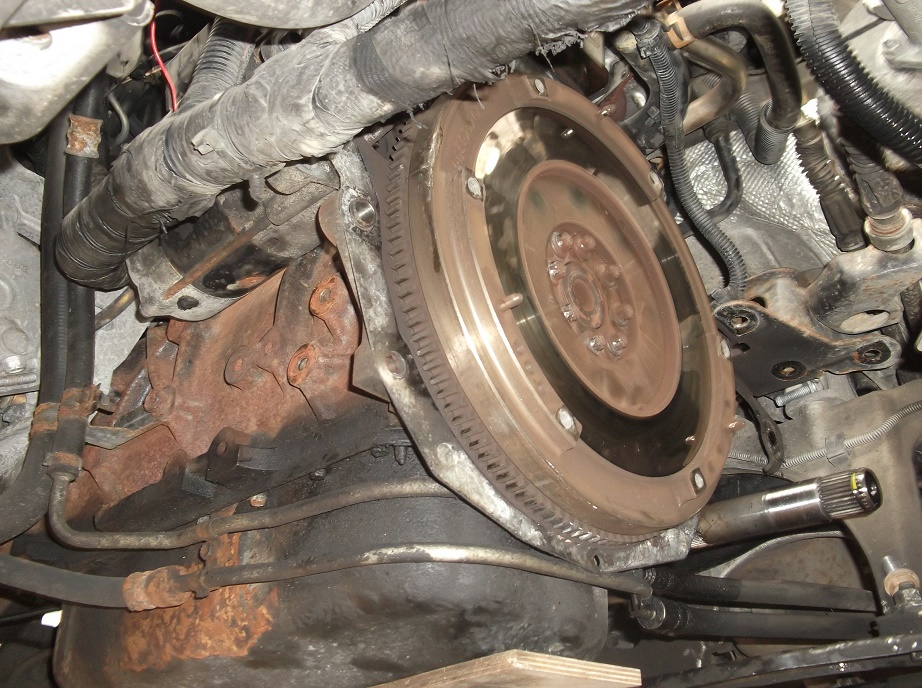

Few Pics of work in progress, Checked the rear engine mount as its accessible and it seems a little floppy? BUT no signs of splits in the rubber??

Well the Voyager is all buttoned up and back on the Road, the Two bearings on the Far Left of the Gearbox if viewing from inside the car had Died, One was notchy but the other was Crunchy and rather Crispy, also almost impossible to turn by hand, so these were replaced by Pete at Solent Gearbox's I would like to recommend him as he does excellent work and only does what is required to get the Box back running, he is NOT a rip off merchant.
