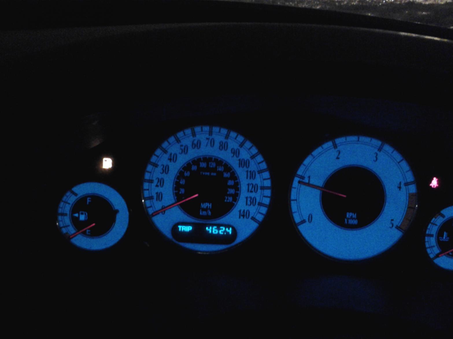

Mine just below 1000
Attached Thumbnails Whats correct engine ide speed for 2.5 CRD-20150113_202205.jpg

- why 2 ?
- your RPM is correct for an automatic
Old Jan 13, 2015 | 03:16 PM

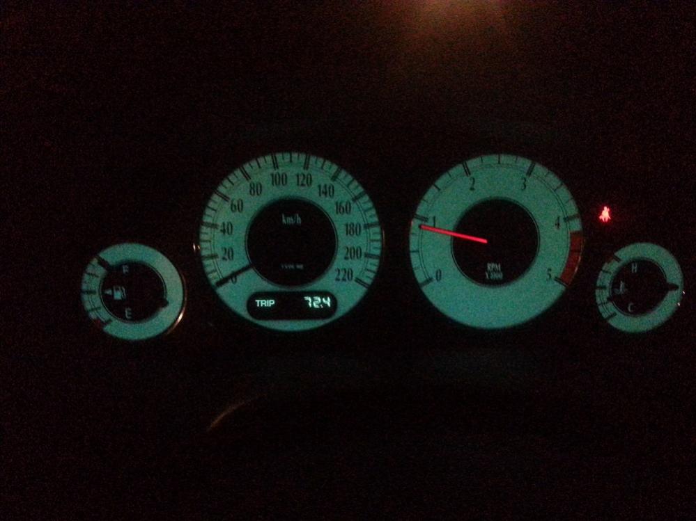

I remember I have a shot of my idle rev (also manual)
BTW I also used had the habit to drive away in gear 2 with manual diesel engines but I found it was not the proper way with the heavy weight of the Voyager. With heavy cars like this you really need to use the 1st gear, especially with a little cargo in it.
Attached Thumbnails Whats correct engine ide speed for 2.5 CRD-2015-01-11-21.58.59-1.jpg
