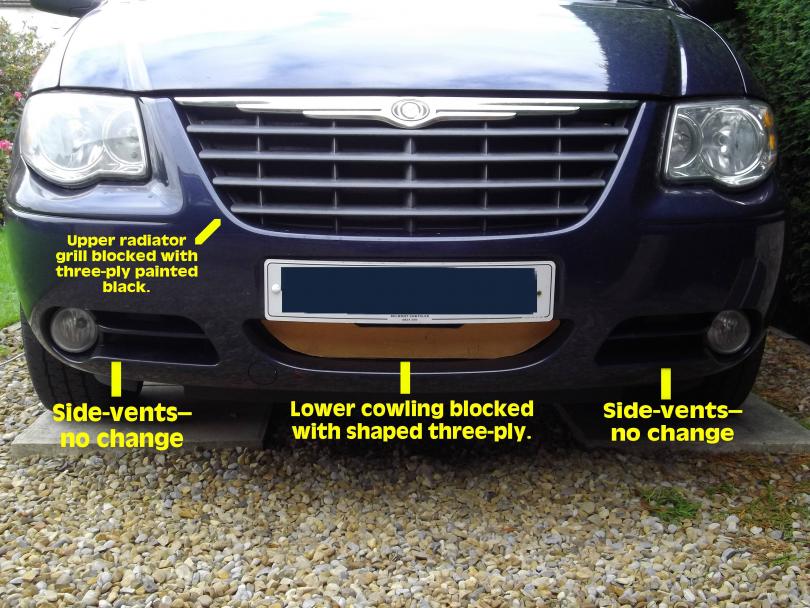

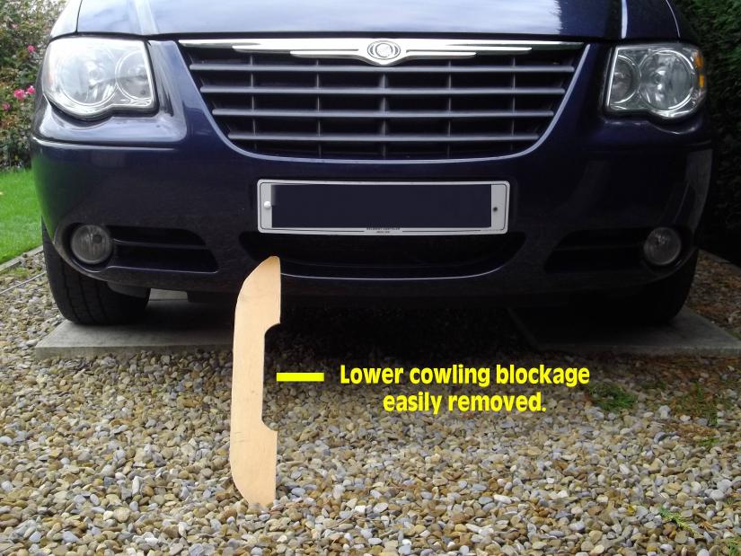

The pictures show what has been done; even with an ambient of 60*F, there was no temperature rise above normal with ALL the blockages in place, excepting a very slight one in an extended traffic jam on the M62. The easy-removed cowling blockage will deal with even a hot climate -- but if that be the case, you wouldn't be doing any of this anyhow... The fabricating and mounting of the main grill blockage 3-ply needed some screws removing, but they are easy and obvious. Painting it black made it well-nigh invisible. Quinteq's idea of using pipe-lagging is a good one, easy, quick, cheap, and not likely to get 'nicked.
There are many of the opinion that if you get the thermostat right, there is no need for any blockage of the rad. grills. I'm afraid this is just wrong. In winter, the icy blast of air around the block(s) blows off a significant amount of heat from those block(s). Just stick your head out the window at only 30mph. in freezing weather, and you'll feel the effect on your face. Or check out cars in really cold countries. Blocked grills are common. Of course, you don't block the actual radiator. If the fans came on, it would still overheat. And you're not going to be using the freezer part of the A/C. The small loss of intercooling for the turbo is also not likely to be a problem in freezing weather either. Please note this part does not apply to petrol engines.

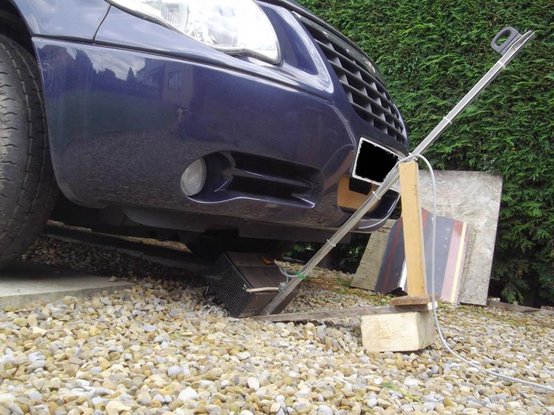

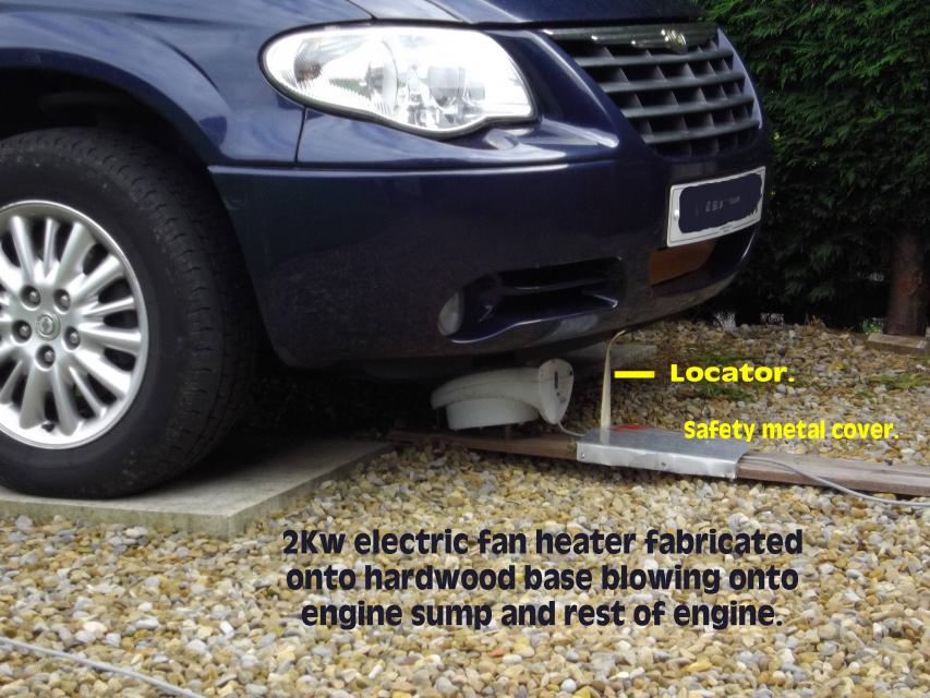

The fan heater on engine sump has been tested for a couple of years or so. 2Kw. for an hour in the cold morning will raise the engine temp. by 6*C., and cost about 30p. And there's nothing to stop you placing a small electric fan heater INSIDE the car...but don't point it at any plastic...
The undersump fan heater will also raise the oil temp. a LOT, making a more easy start and very much less wear in the cold warmup. The modest heating of the battery will also help. Ok., an in-line water heater and pump fitted in the bottom hose will be much more efficient, but a lot less cost effective. The fan heater isn't going to cost you £250 to £350 in total. It cost me a fiver, Leeds market. BTW, don't bother with electric sump heaters -- they are too small, and only heat the oil anyhow. Those you push down the dipstick hole just fry the oil around them.
You'll need to cut away some of the 'struts' of the under-cover, this is no prob. Tin snips work best here.

I've improved the efficiency of the engine pre-heat with an electric fan heater; now it lifts the engine temperature by about 12*C for the same kilowatt hours. (I have a separate temp. sensor on cylinder head, I don't rely on the Chrysler one). The cranking is now noticeably faster when cold.
See picture which is self explanatory, and by making a discrete mark on the number plate I can locate the device correctly without kneeling down. A little more of the undertray needs to be cut away to suit this partic. fan heater.
All ready for the really cold stuff now...
