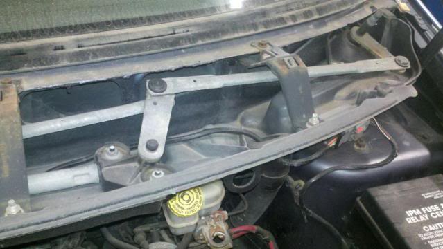

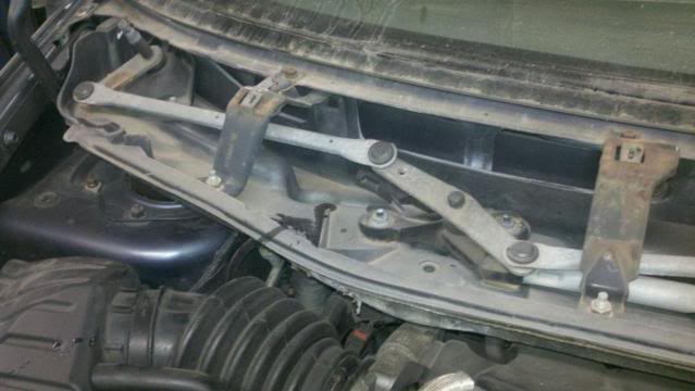

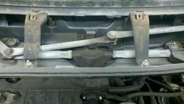

It just so happened that I had a class mate that is a Chrysler tech that I ran across after years.He was kind enough to supply pics of how the wiper arms and motor poistion should be.Now this was from a 1998 T&C but I looked and done just as pics on my 1996 and they work fine now.Hope this will help any others that might have to replace there motor as well so they don"t spend alot of time like myself going back and forth trying to get timed.Name:  CenterMotor.jpg

First pic is motor Second will be right side Name:  LeftSide.jpg
