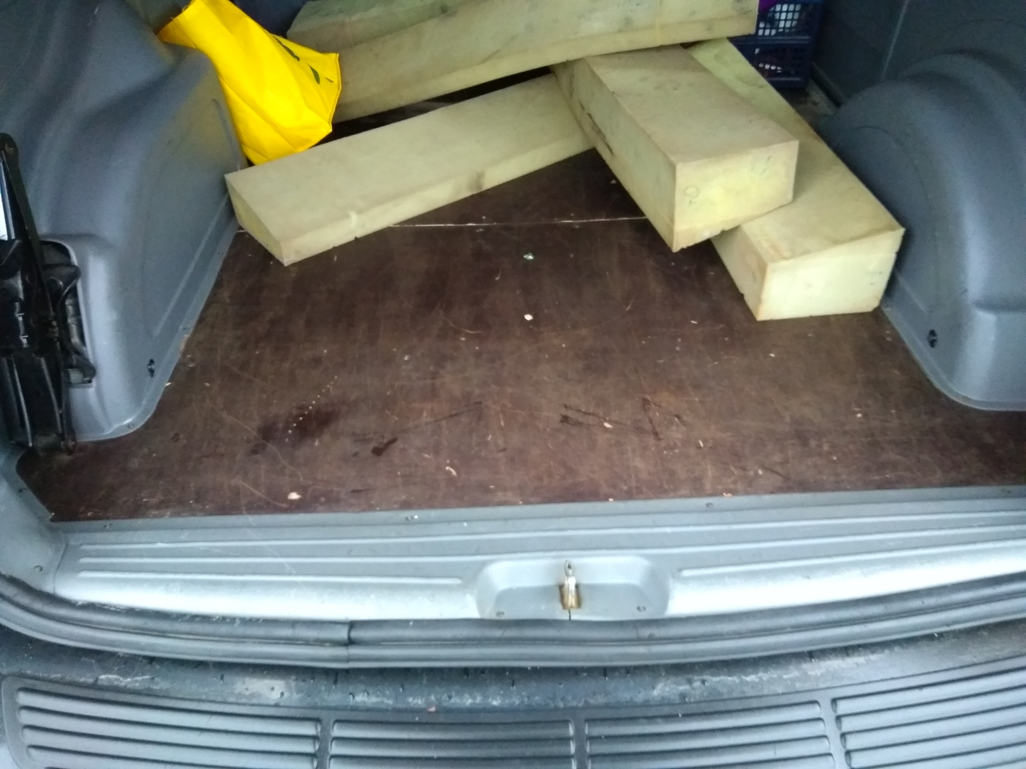

I have bought a Voyager from 2007, and I can't figure out how to lower the spare wheel.
The wheel hangs behind the rear axle, and it normally is lowered by turning a bolt inside the loading space, located five inches from the rear lock, slightly off center to the left. There should be a hole in the floorboard to access that bolt. I had two similar vans before and that is how it works.
In my van the floor is uninterrupted where the hole for the bolt should be. And no, the wheel is not in its alternative location underneath the front seat with a bolt in front of the center console between the seats. I intensively searched the internet, but no solution. Much head scratching ensued.
I can take out the floor board and check, and eventually drill a hole in the board but that is rather a lot of work, because you have to first remove the inside panels. Also, should I assume that in the last ten years nobody had to change a tyre on this car?
Anybody heard of an alternative location for the said bolt?
Thanks.

Hi Rebel, you may well be right, but I have no way to check the safety latch either, because there is no access to the nut that lives (presumably) under the floor board. The car is just a van, without seats exept for the driver and codriver,
I added a picture.

Thanks for posting the picture , clears things up nicely. Looks to me like a previous owner did a rather nice flooring modification, and did not leave the normal BARE floor or carpeting access spot.
I assume your location is in the Netherlands(NL), as our US cargo versions come with bare metal flooring or carpeting. Good luck on some unwanted disassembly of that wood flooring.
EDIT: Only other suggestion is to go underneath and see if the spare is secured by a carrier BOLT from underneath(like on some other makes of vehicles) Owners guide book should also give you the info you are seeking.
