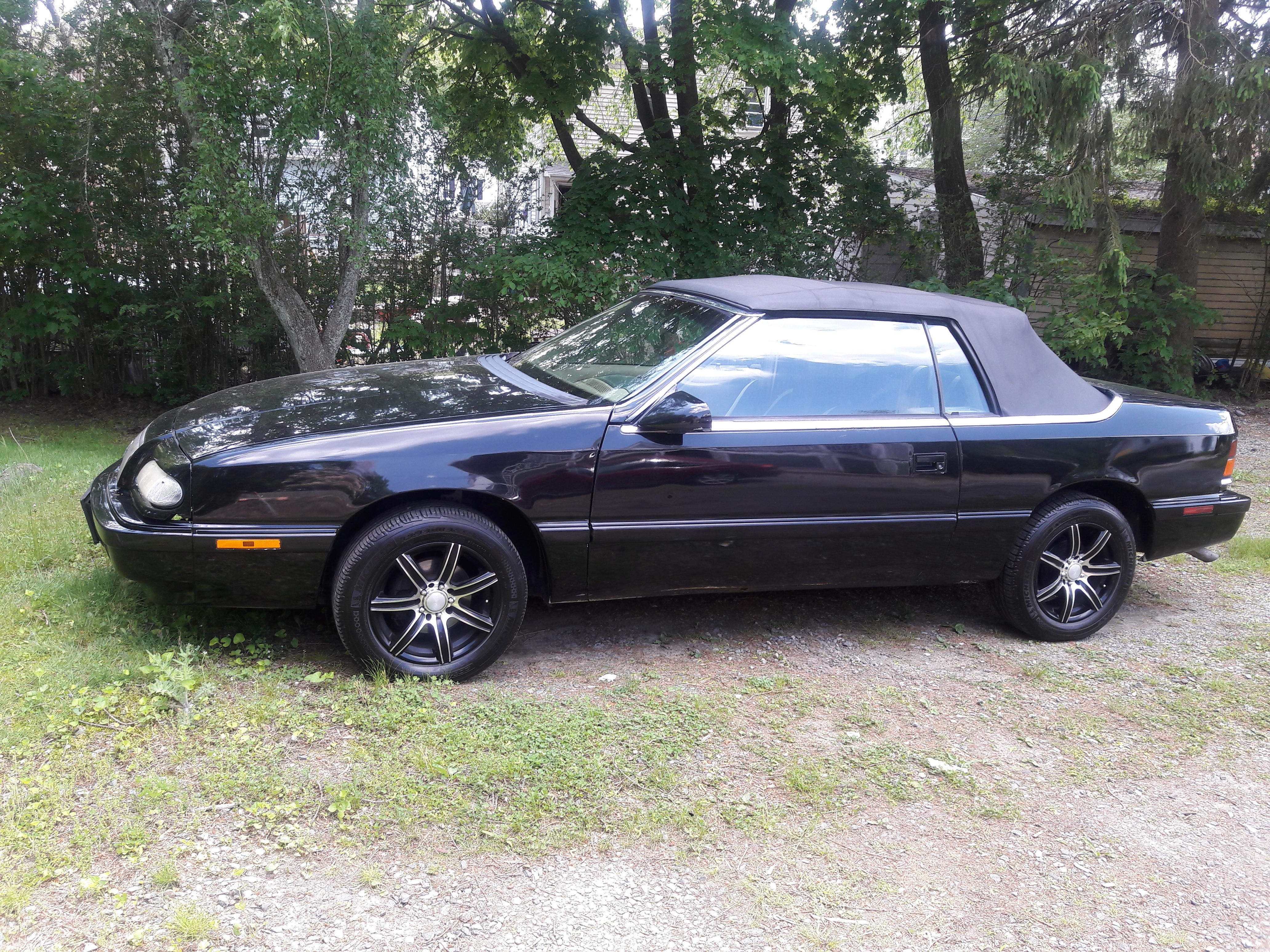

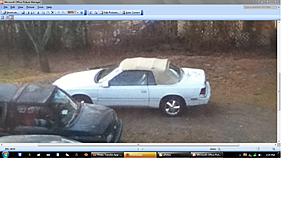

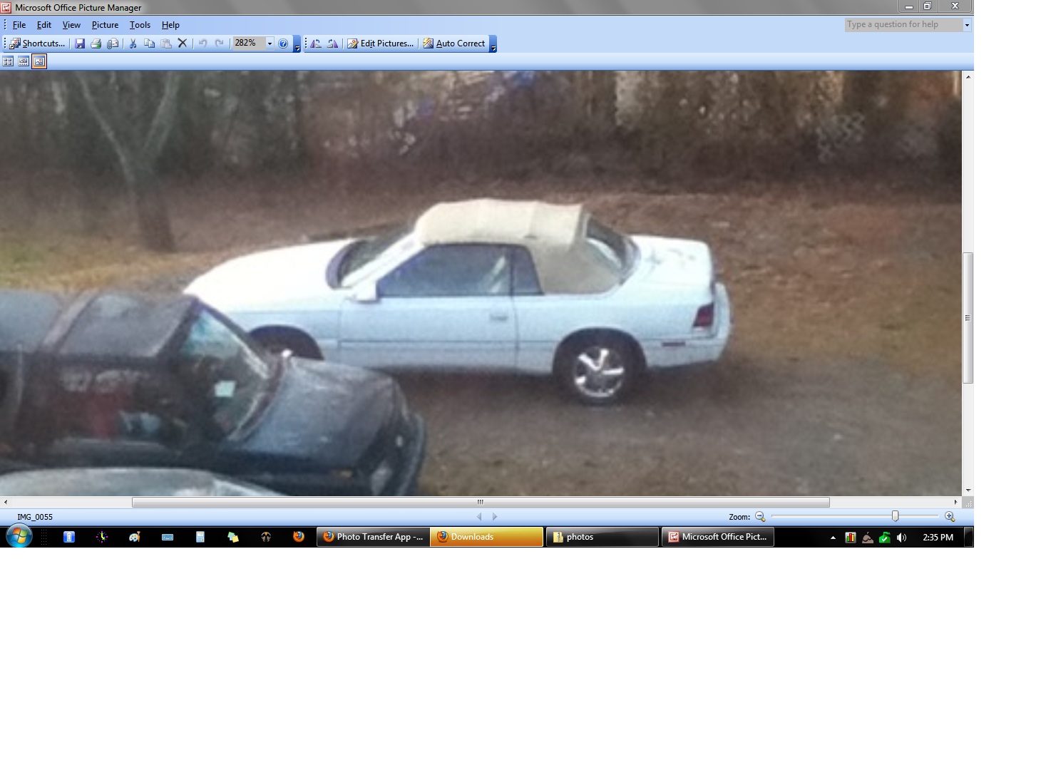

I've include photos of what it looks like now and what it looked like when I bought it for $100.
Attached Thumbnails Convertible top switch-2017-05-19-14.15.50.jpg   Convertible top switch-2015-04-29-14.33.46.jpg
