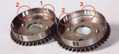

Here are the tone rings I've found:
I have ordered the SBEC cam gear and it seems like its the right one on this image. I can't find the left one and I think that's the one I need.

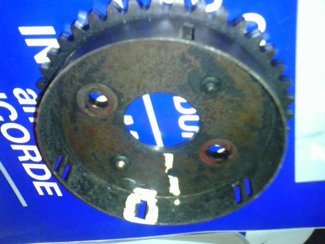

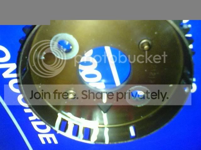

Just a pick of a different one I found on the internet
http://i890.photobucket.com/albums/a...effpulley2.jpg

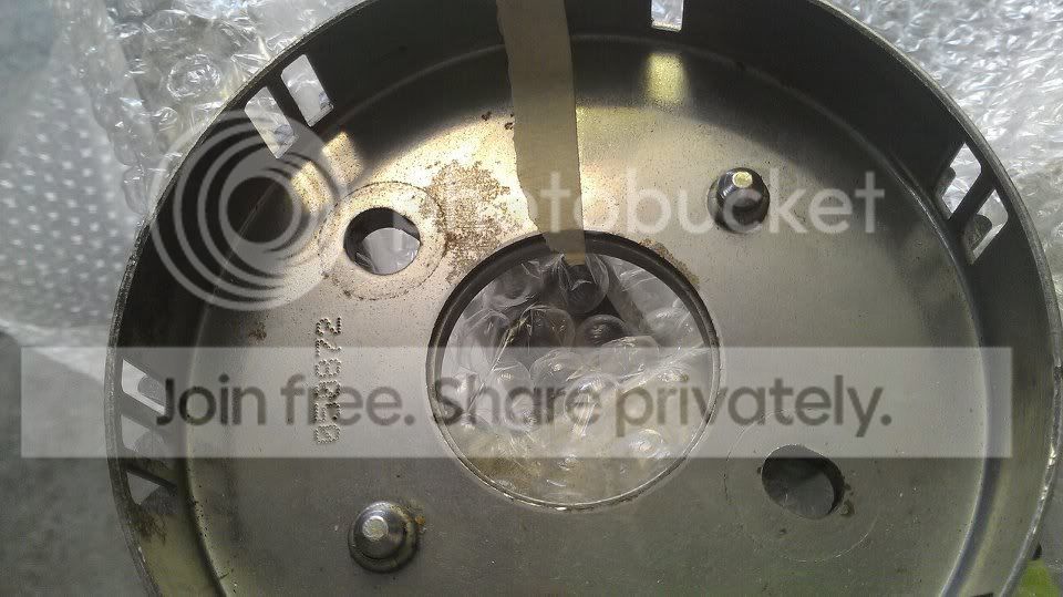

This is the cam gear that I ordered that is suppose to be the right one but it is the same one that is in the car now.
