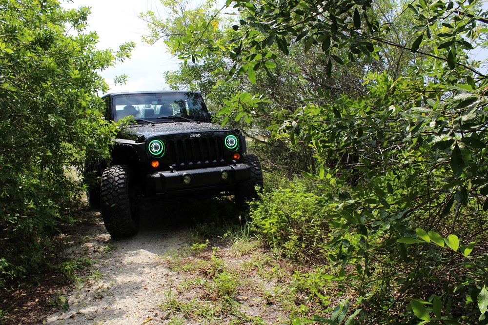

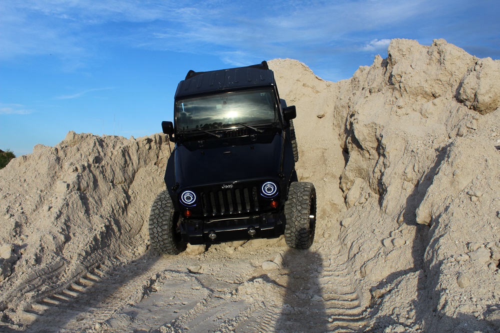

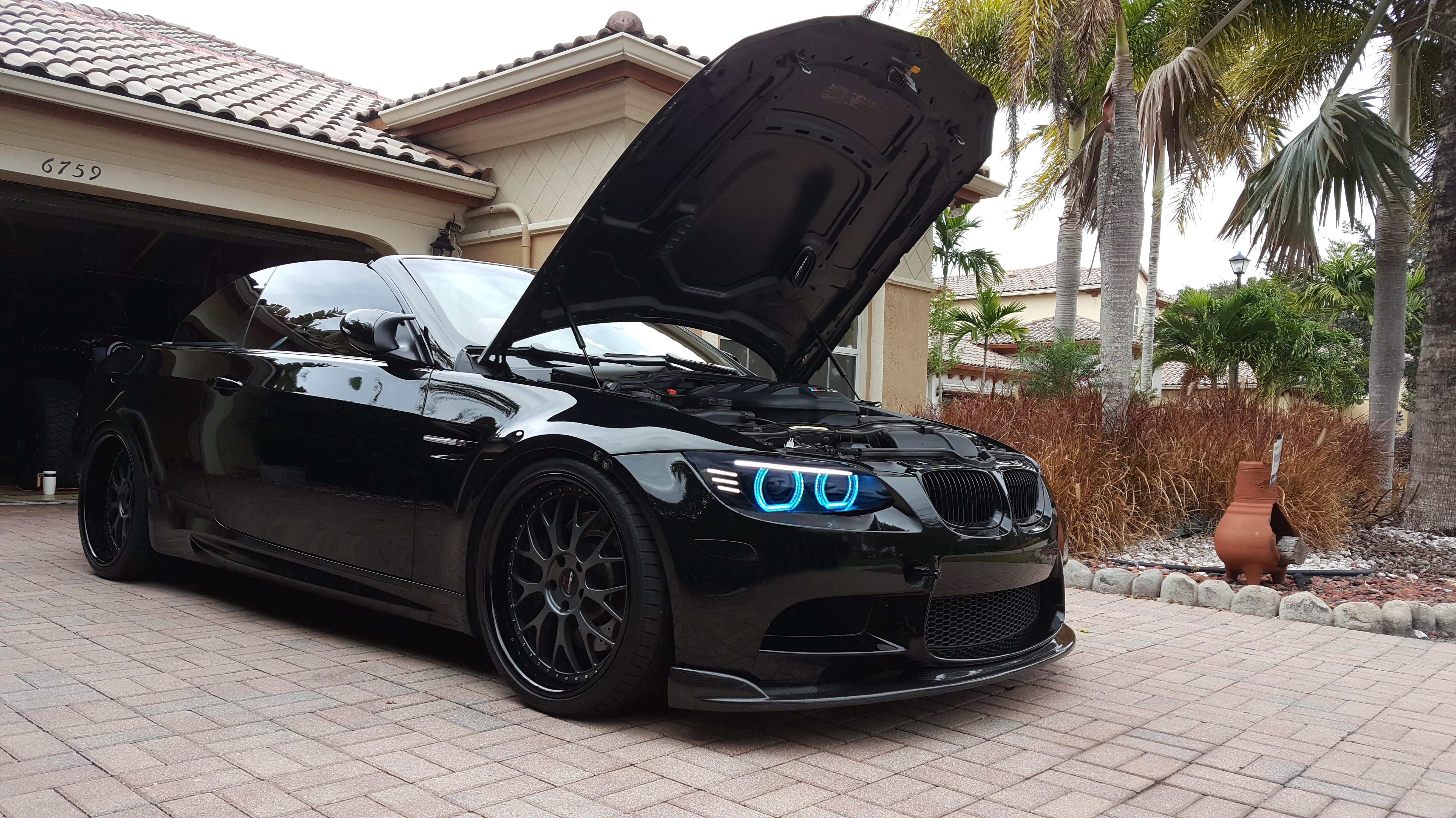

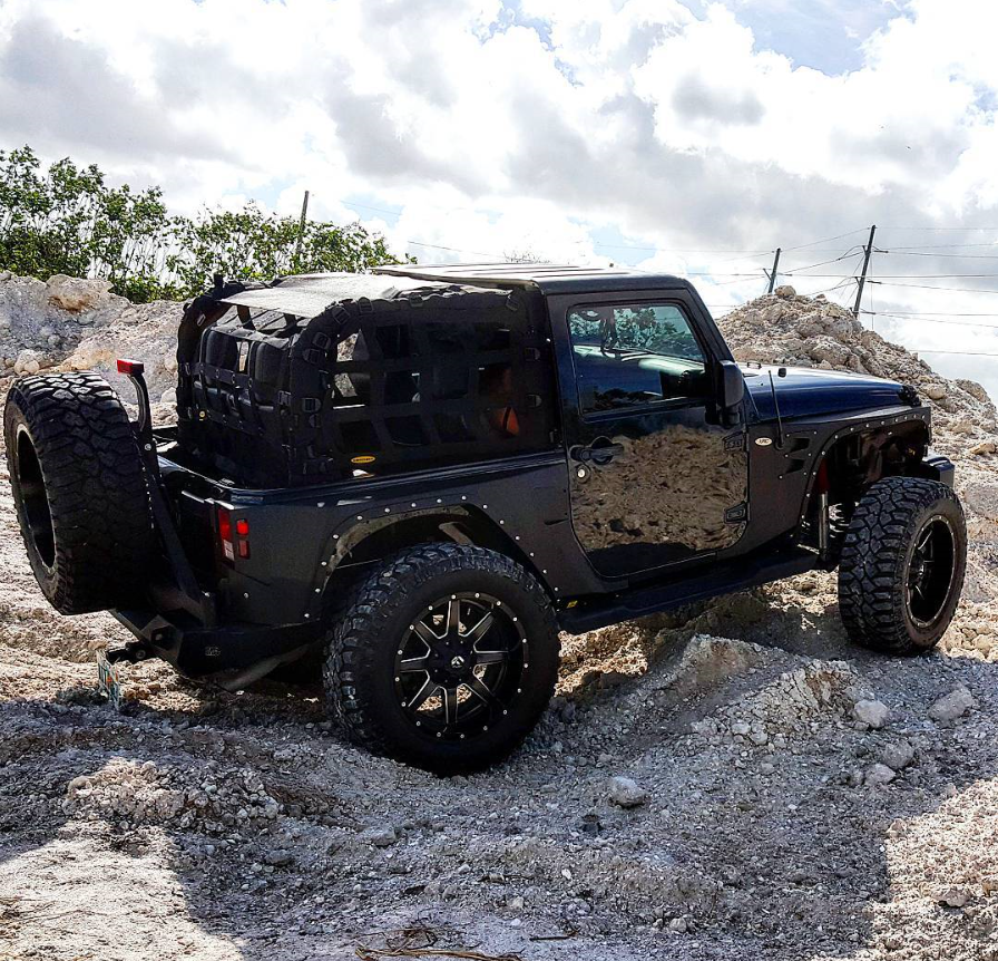

Every single pieces built and installed by me. Headlights are hand made and customized by me as well (Multi Colored)
This is for M3 :
DIY E93 RGBW DTM BLACK-OP w/ SWITCHBACK EYEBROW (Completed)
This is for JK :
JK Bi-Xenon Handmade MultiColored Remote Controlled Headlights - JKowners.com : Jeep Wrangler JK Forum
