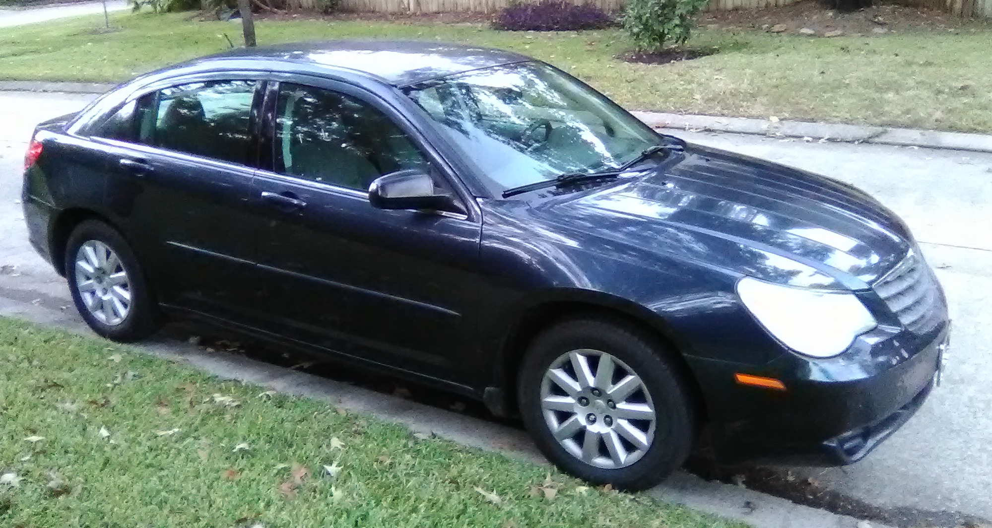

Just bought this needs some cosmetic but it was way below KBB, getting great gas mileage, fun to drive and brakes work really good. :' ) BTW previous owner had a dog and the back seats stink any tips would be great. I was thinking a bucket of hot soapy water would do the trick but I do not have access to a wet-vac.
