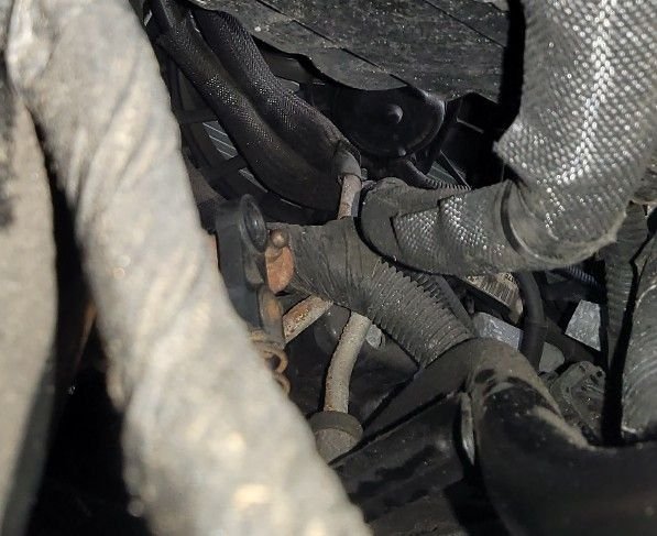

The shifter linkage at the transmission has failed. Apparently the BUSHING holding the cable assembly to the plate that does the shifting has failed. The shifter no longer works. Here are a few pics.
Top photo, the black ring is from the cable to the shifter. It sits on the pin/nub... what ever you want to call it. it is held on by a bushing in the black ring which has disintegrated.
Chrysler really gave me the run around. They said the part is no longer made, gave me some bogus part numbers that had nothign to do with it. Now I am afraid the are going to tell my stepfather it will take 2 weeks to get the part if they can find it and charge hime over 450 for the cable plus labor.
Does anyone know a parts place that carries that bushing???
