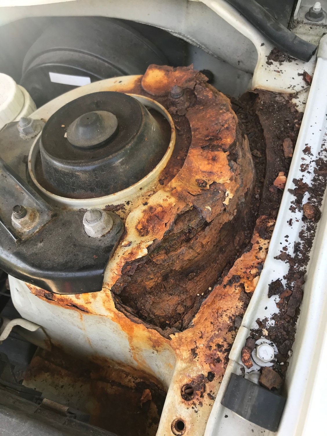

Old Sep 21, 2020 | 12:46 PM
Adina Homrich's Avatar
Joined: Sep 2020
From: Shelbyville, Michigan
Default Is it too far gone??
If the metal is still strong, just sandblast the rust off and paint it well. If there are weak spots, you can probably get a good body shop to weld in some reinforcements where needed.
2004 Sebring coupe limited. Is it too far gone?
Old Sep 21, 2020 | 04:42 PM
REBEL59's Avatar
Joined: Jul 2017
Posts: 957
From: Western NY
Sadly, In my opinion, YES it's too far gone.
Old Oct 9, 2020 | 01:27 PM
Jon.litman's Avatar
Joined: Aug 2020
Posts: 16
Yeah, that is very far gone. Even if you replace the metal on the strut tower, you should still try to find how your strut tower got rusted in the first place. You could have a leak ieak that allowed water to get in there and make the strut tower rust. Most likely it is going to be near the strut tower that is rust. Also, is your other strut tower rusted?
