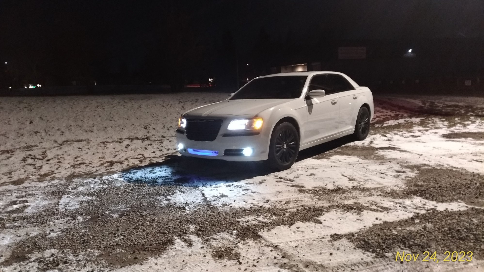

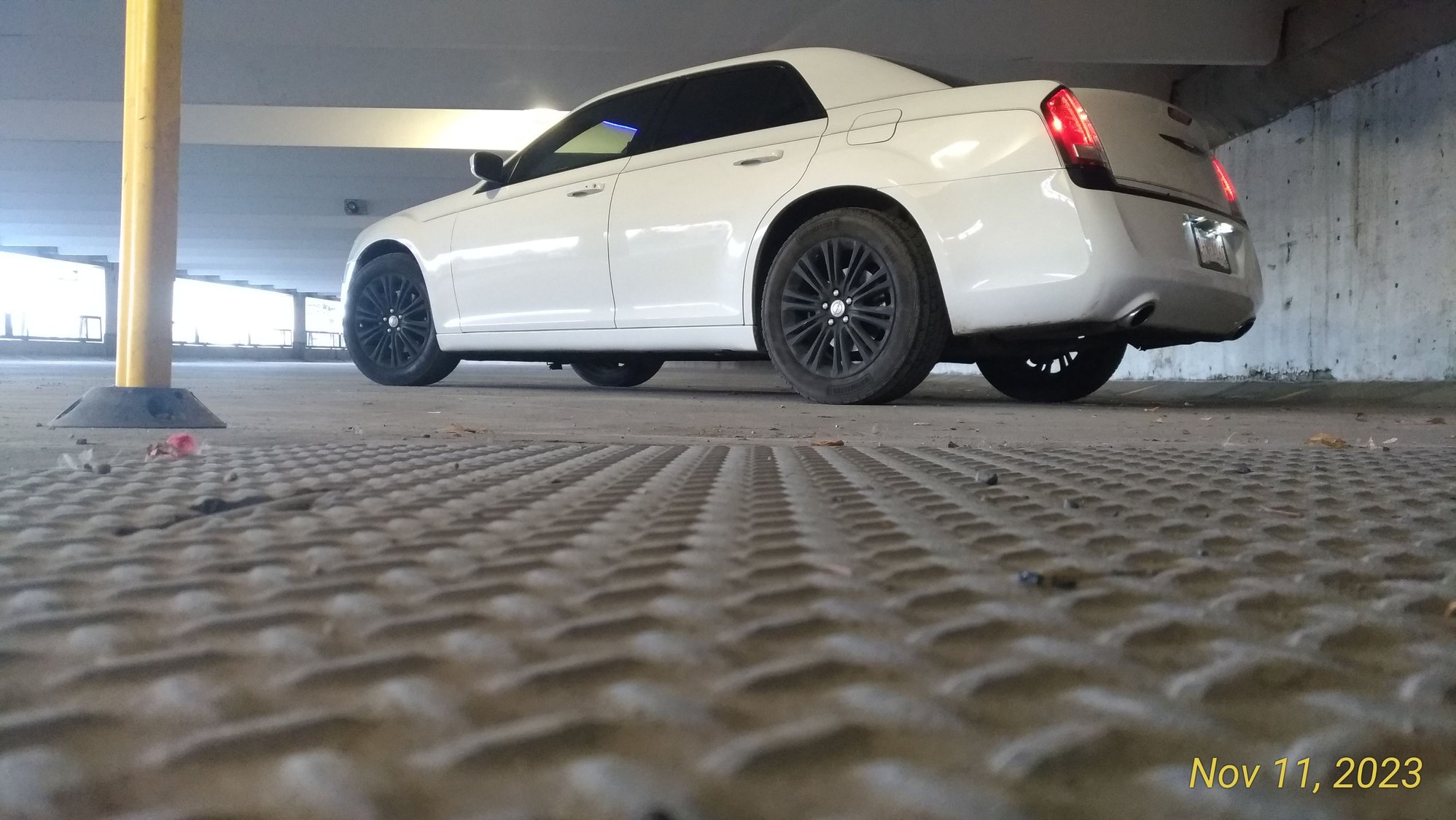

That's my fifth one, the last of going through all trim levels ending with a base. I should have started with this one, I only have two of the others a black sport and a C all second gen.
