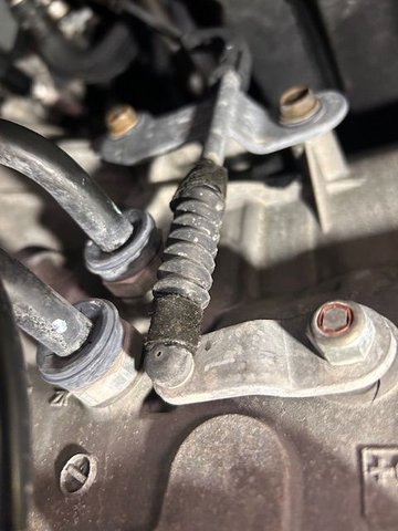

I found what I believe to be the neutral safety switch on the drivers side of the trans. Called NAPA, AutoZone, Advanced Auto and O'Reilly's, none of them have this part. It's not out of stock, they don't carry it at all.

Looks like a NAG transmission that would be inside the transmission on the valve body plate
