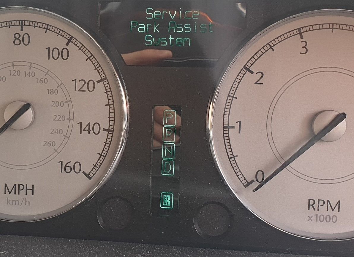

  • Car dashboard says “service park assist”

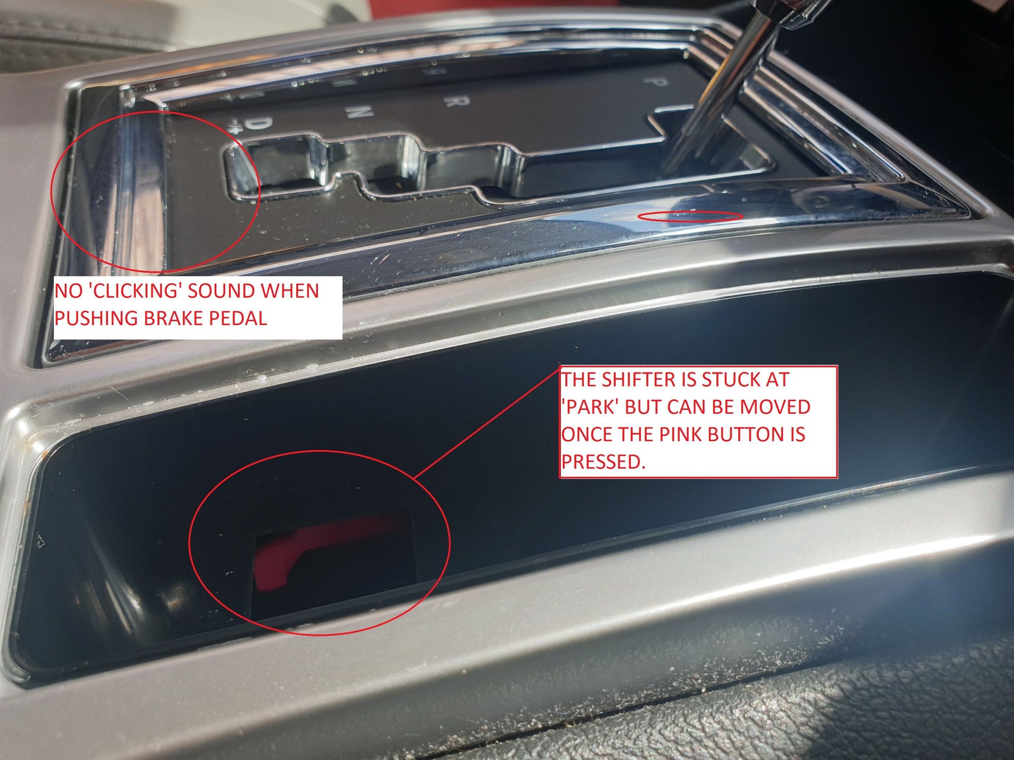

  • Transmission shifter stuck in ‘park’ however I can move to ‘D’ when pushing the secret pink button on the side. There is a speed limit with only 1st gear working.

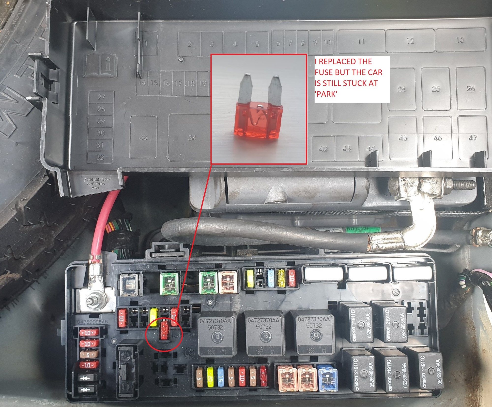

I took the car home, checked visually all the fuses in the front and back and found only 1 burnt, but the car shifter is still blocked.

it seems it is not the 'pink thingy' issue, but rather shifter solenoid - am I correct? When I’m pushing the brake pedal I cannot hear any ‘clicking’ noise. Where can I find that solenoid? What is part No.?

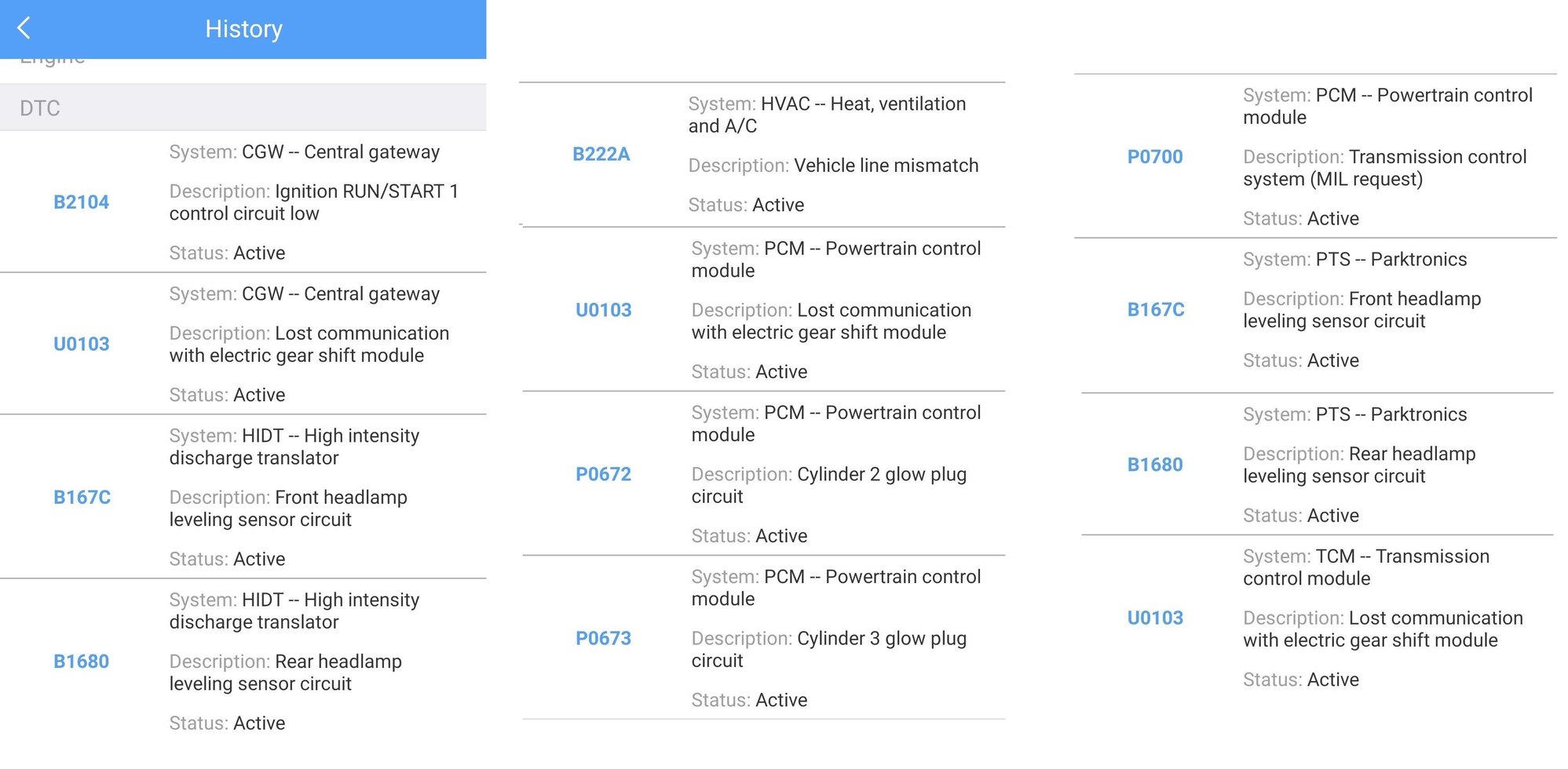

What else I could sort out myself? When looking at the active error codes… Is my car totally messed up now?

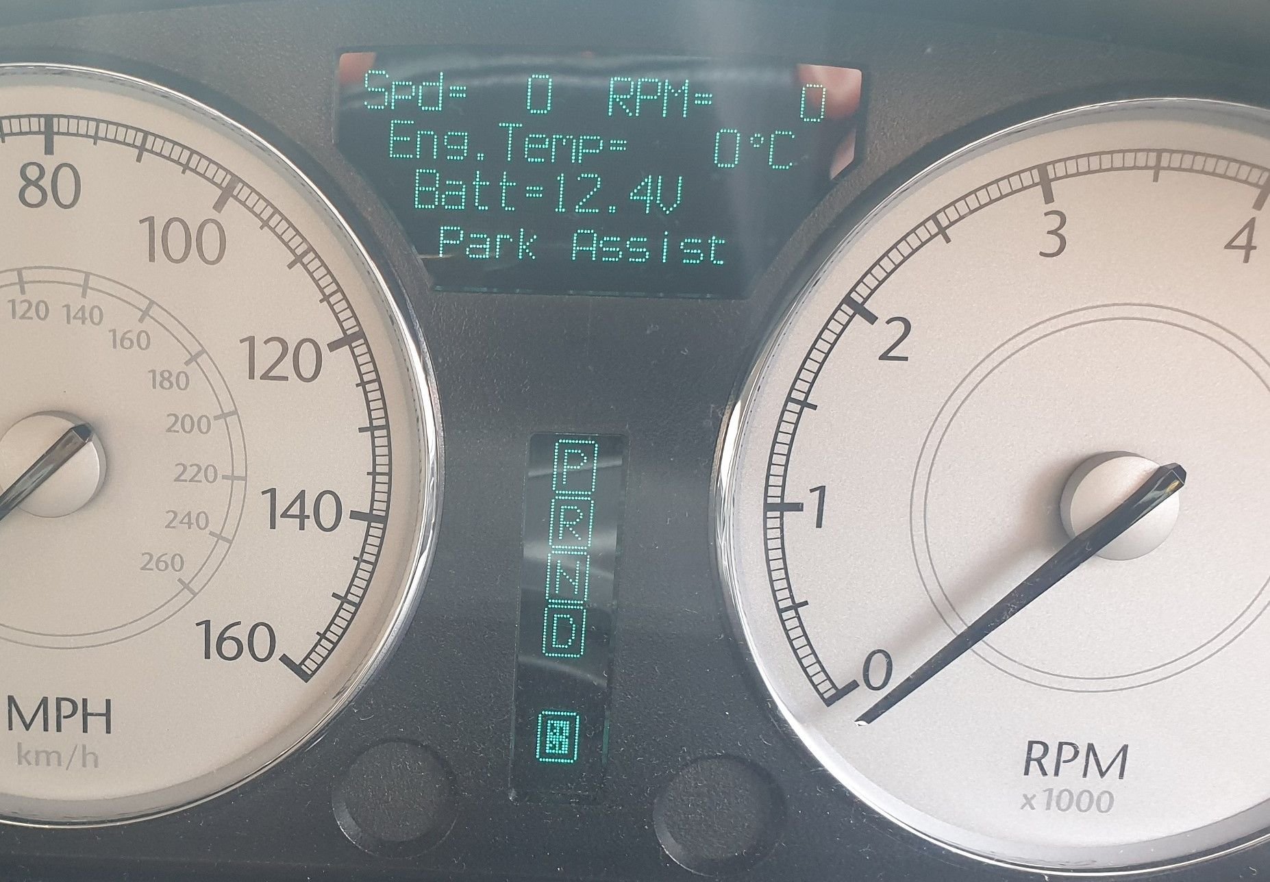

The battery is 2 months old. I took it out for the night and charged. The mechanic left it at approx 20%. With motor OFF I have 12.4V on the EVIC dashboard. When driving with lights ON and AC on full output it keeps steady 14.6V.
Originally Posted by ggoose
The charging voltage is extremely high; should be around 14.4-14.6 volts. How were you measuring the voltage to see 17-18 volts? For a charging voltage that high, I would suspect possible corrosion somewhere in the charging system wiring, a possible bad/missing ground or even corrosion at the battery terminals.
I keep the voltage preview on the EVIC dashboard all the time as per the screenshot. Now, with the replaced alternator the voltage is steady as mentioned above, but the shifter is still locked unless I push the side button with the only 1st gear working.
