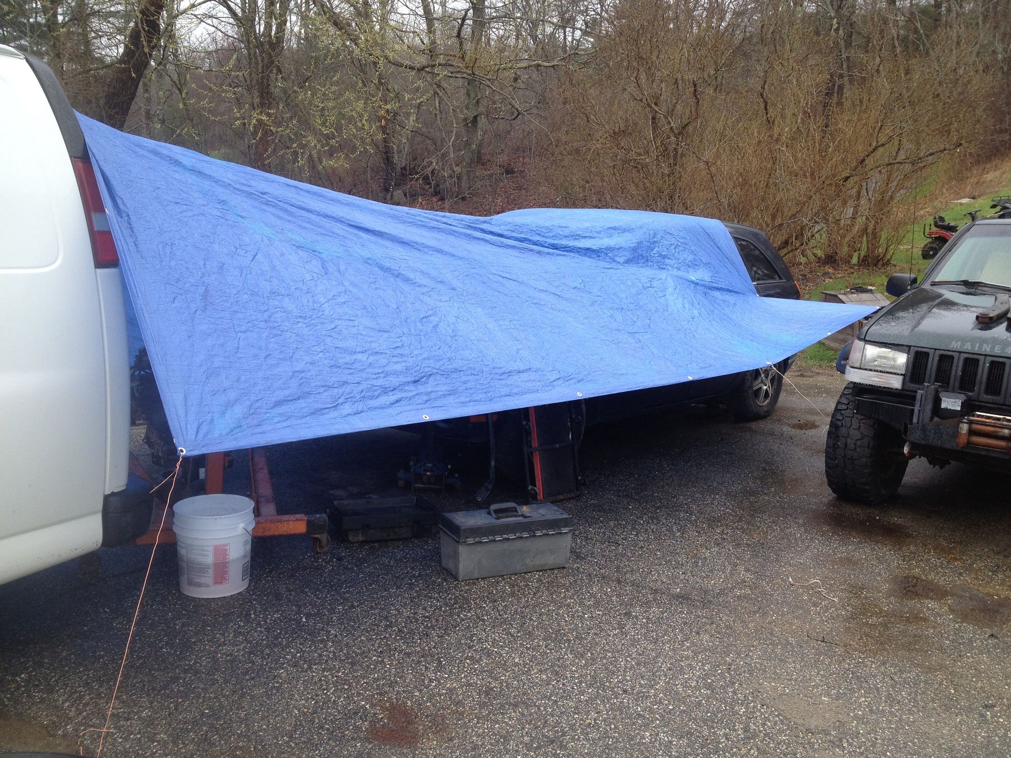

Here's a few pics of removing the engine, my redneck tarp garage, the empty engine bay, and the exhaust studs I was lucky enough to be able to remove with far less effort than I expected!

Good stuff! Love the redneck shop cover, not everyone is willing to keep working thru the rain. New motor is relatively young at 135k, only maintenance the 3.5's need is the timing belt, perhaps you can find evidence that it has already been changed, else is a whole lot easier w/ the engine out of the Pac. How many hours did it take to wrestle the engine out? Keep us posted!

It took me a week of evenings to get the engine ready to pull out. Some of the bolts took an hour each to get out, and I spent a lot of time raising and lowering the engine to make clearance for silly things like my hands and maybe a tool. Lol
After I hooked onto the engine and unbolted the last 4 engine to transmission bolts I had left in place, it took me about two and a half hours to figure out how high to jack the transmission in order to get the engine away enough to come free.
Let's just say that the engine is 1/4" longer than the distance from the edge of the engine bay to the mounting face of the transmission, so I really had to make the planets align perfectly in order to complete this task. Lol
Then I still had to manage to get it out between the firewall and the radiator with both exhaust manifolds in place, being careful not to break any of the 4 O2 sensors, which is a trickier thing than it sounds like. Lol

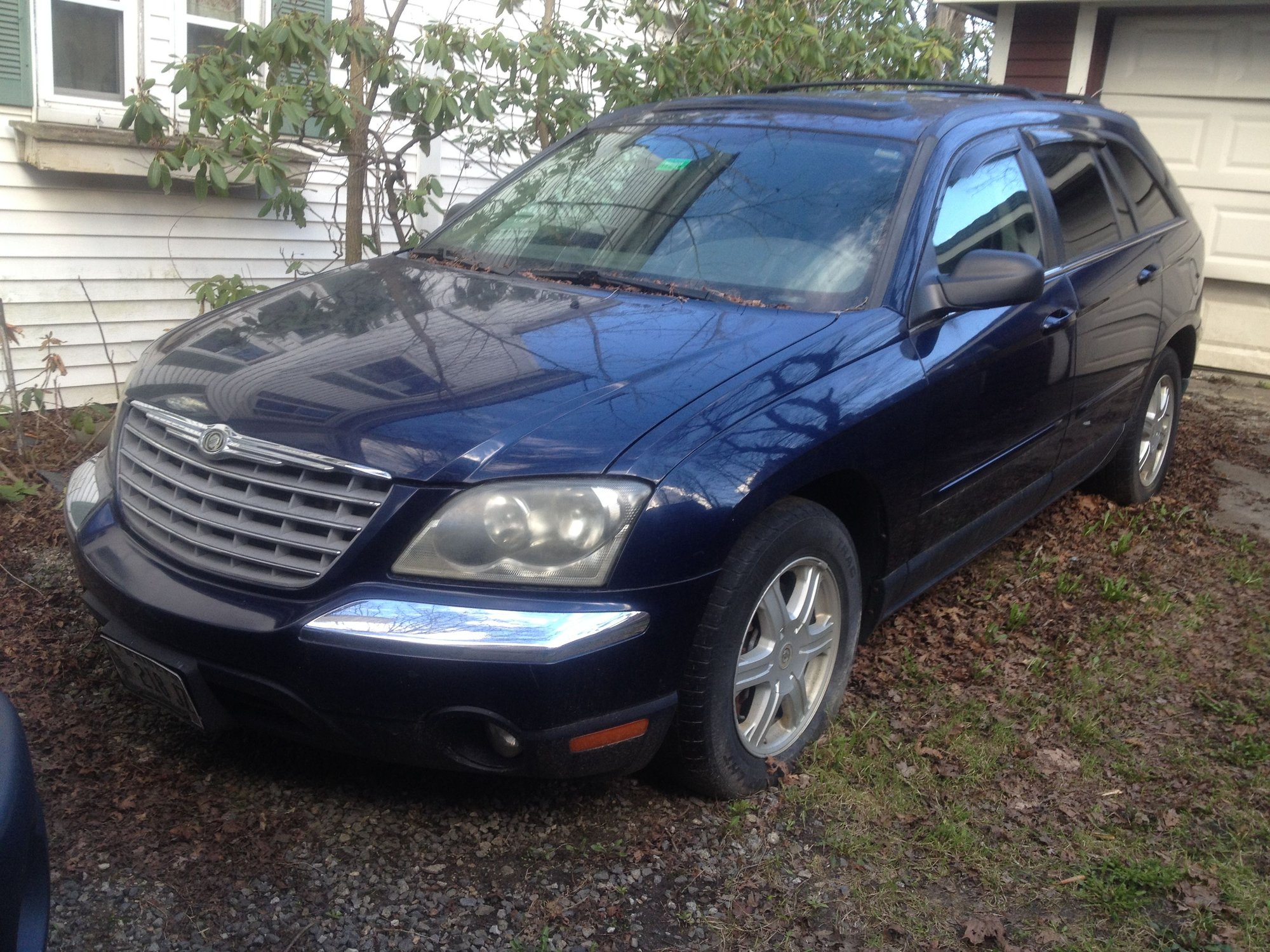

But on the lighter side of the news, I was given a modern blue '05 Pacifica a few days ago for a parts car.
It's a 3.5L 4 speed with no reverse gear and a broken K frame, but it ran and drove forward when it was parked.
Being raised properly, I hate to look a gift horse in the mouth, but......
It's been quite a pain in my **** from the get go.
It sat for a year before the previous owner bought a new house and had it moved on a flatbed to the new house, where it sat for another 3.5 years.
Well....
The flatbed driver just winched it on and rolled it off the truck, left it in reverse but somehow got the key out of the ignition switch, cranked the parking brake to the max and there it sat.
It's physically corroded stuck in reverse and therefore won't engage the starter because of the park/neutral safety switch.
The parking brake is physically stuck fully engaged.
I had borrowed my boss's truck, trailer, and 10K lb come-along to move said parts Pacifica.
After an hour and a half I had moved my boss's Tundra and trailer backward 6 inches and moved the Pacifica forward 8 inches.....
That sumbitch isn't going anywhere.
All I really want it for is to swap from 2 row seating to 3 row seating and add heated front seats to the '07 and maybe a few other parts, but it's been a big headache so far. Lol

The parts Pacifica
