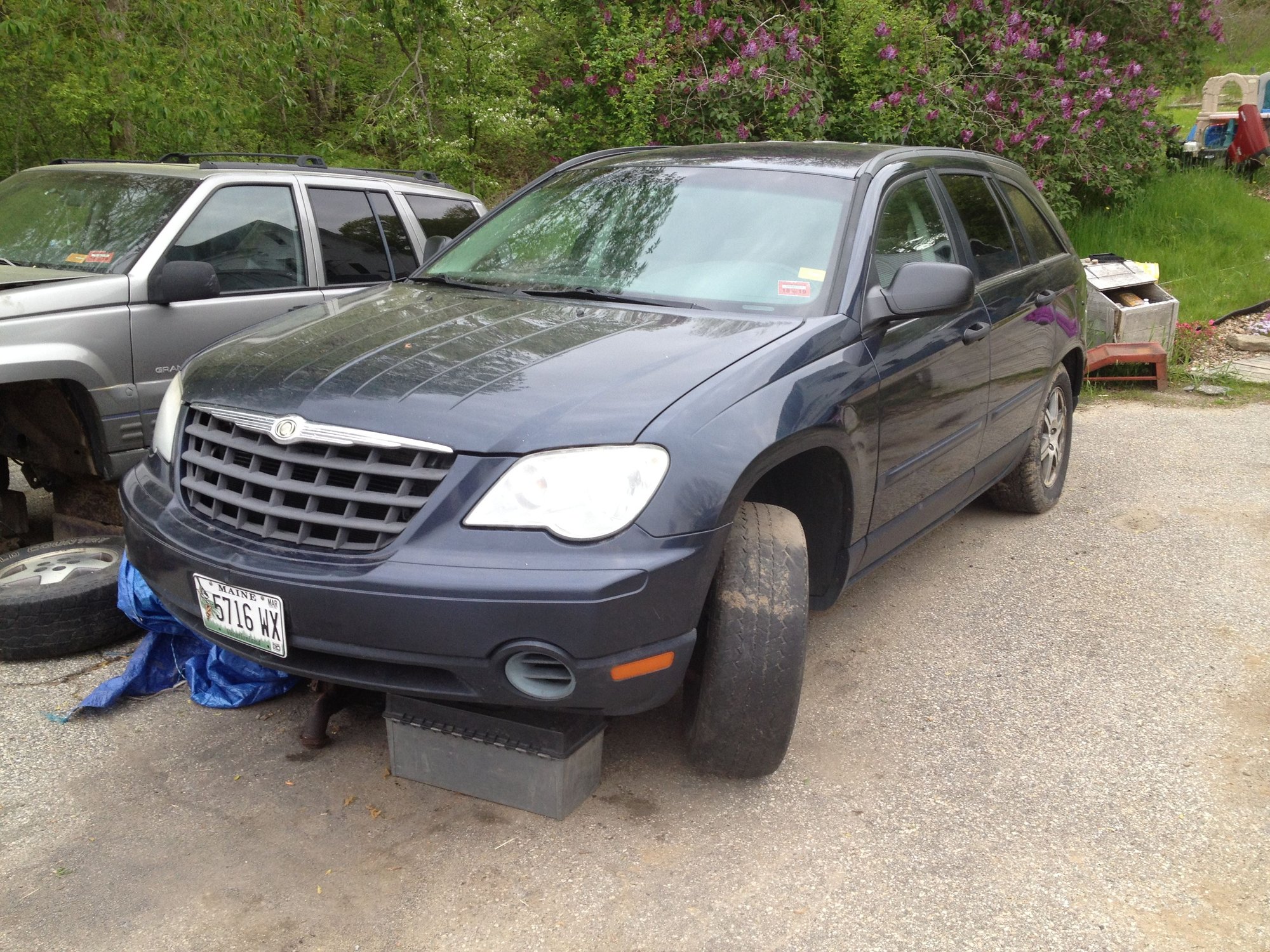

So, today I was able to make a bunch of progress on the ol' Pacifica!
I finished changing the engine wiring harness, installing the exhaust manifold heat shields, the coolant lines and hoses, all of the EGR and vacuum lines, had the alternator checked at my local O'Reilly store(passed the tests and produced 14.7 volts) and installed that and the serpentine belt, installed the air box, the upper radiator support, headlights, grille, and hood!
It actually resembles a Pacifica now!!! Lol
I need to put the right front knuckle and axle back in place, bolt the torque converter to the flexplate, put the exhaust Y-pipe back in, change the transmission filter, add an oil filter and oil, along with coolant and ATF+4 and I'll be ready for the initial startup!!!
It's a really good feeling to be able to take the tarp off it and to be able to look at it from the front and tell that it's a Pacifica!!!
After the initial startup, I can weld in my new rocker panels that I've had since 2 days before the oil pump went.
Then a new set of sneakers will have her to a point where she'll pass for an inspection sticker with ease!
I'm hoping to hear it purring like a kitten within a week or two, barring any more emergencies that directly effect my wallet.
I also hope to have a chance to see if I can get the parts Pacifica to roll enough to be put on and taken off a trailer so I can get it home and start stripping parts off it.

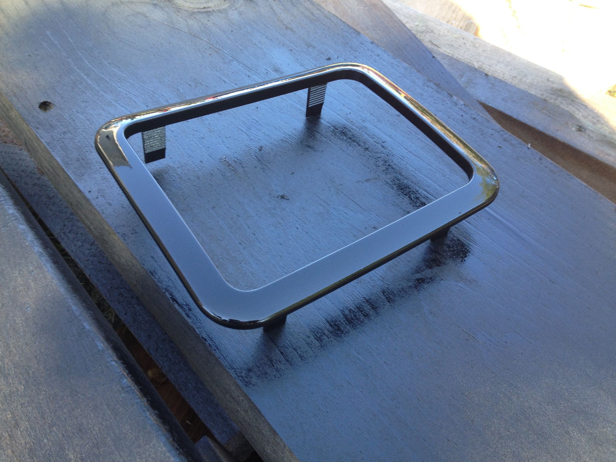

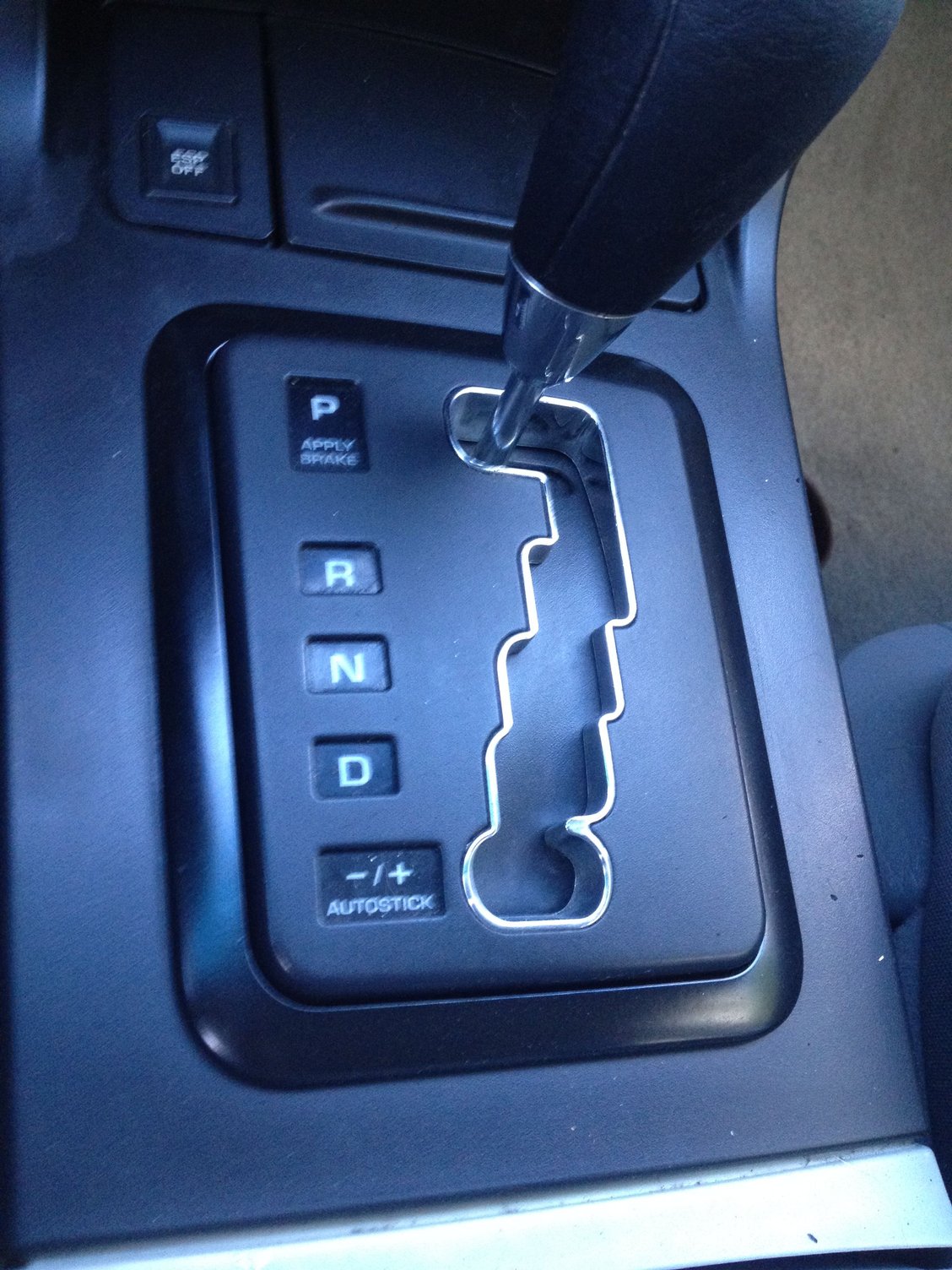

The only thing I've found about driving it that I didn't like was the sun's reflection blinding me off the chrome bezel around the shifter.
So, I performed the "OMG, stop blinding me" mod; scuff the bezel heavily with fine grit sandpaper and give it a good thick coat of satin black from a rattle can.
We'll see how well it holds up. Lol

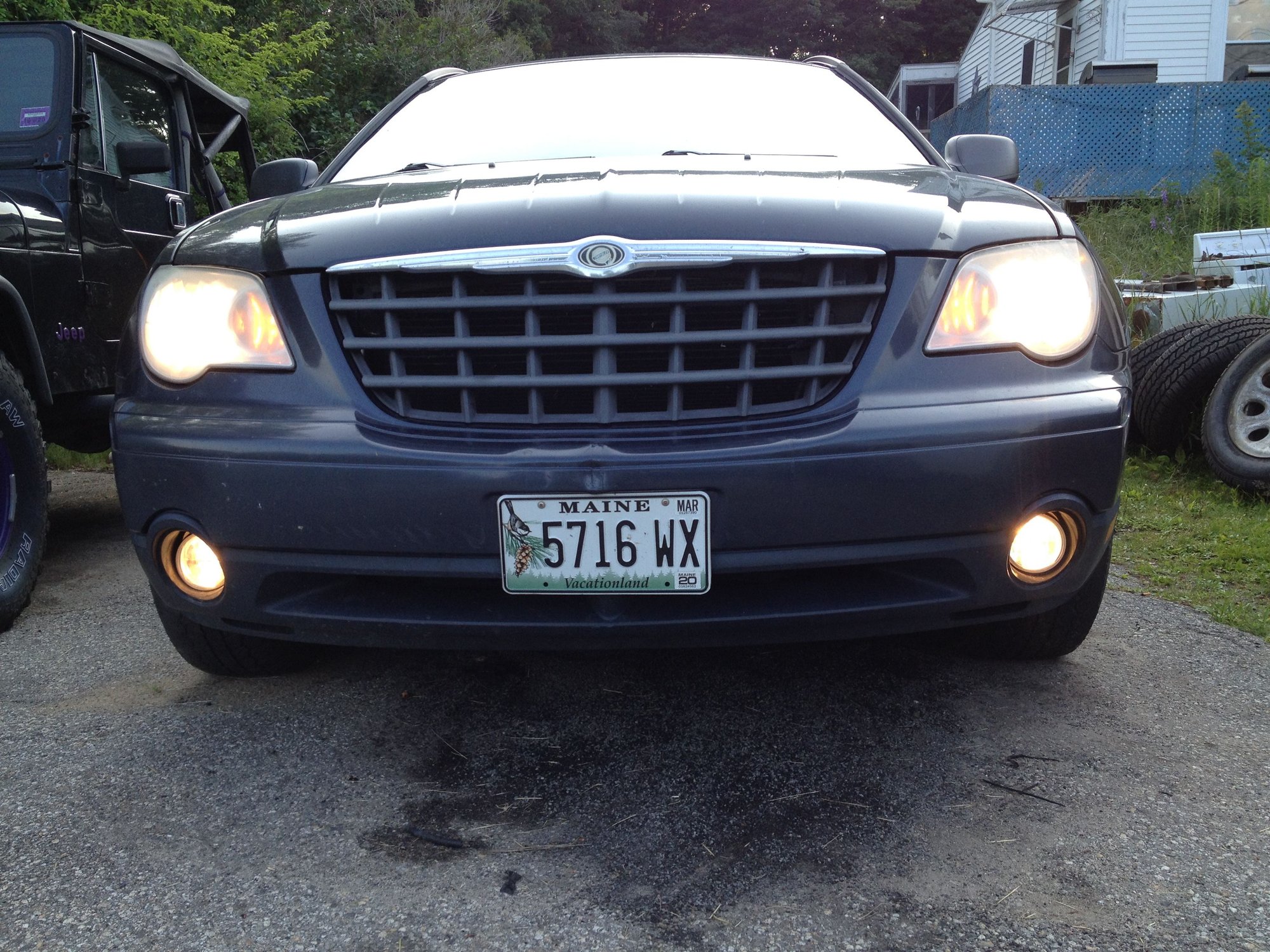

Then I decided that driving lights would be nice to add.
With the exception of the driving light connectors being a different style from 05 to 07, this was a plug and play add on.
No additional relay or fuse swapping necessary!
I took only the light units with the connectors and 6" of wire(to splice to Blue's wires, which were the same color wires between the two years) along with the multi function switch(turn signal/headlight/hi-lo beam) assembly.
I take back half of the things I said about the Pacifica design team, that was the easiest 20 minute mod I've ever done!!!
