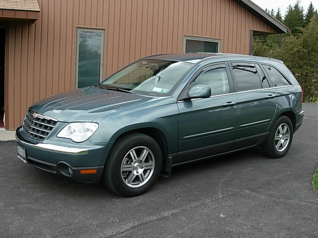

Old Apr 27, 2009 | 07:23 AM
SARG's Avatar
Joined: Mar 2008
Posts: 144

I had AVS (Auto Vent Shade) in channel on my 07 pacifica and they did not work due to the auto up feature on the car. When the glass touched the visors it felt the resistance and opened back up again. So I went with the regular tape on style and they are good. No wind noise. they look good.

To a very small degree. Sometimes the glass will touch the shade and will reverse but I just re-hit the button and they close.
If the situation was constant I would alter / change the programming on the auto up feature before I'd use the glue on shades.
The engineering is quite different on the Weathertech from others I've seen and the edges which are inserted into the channel are very thin i.e. perhaps as small as .020 on the edges.
