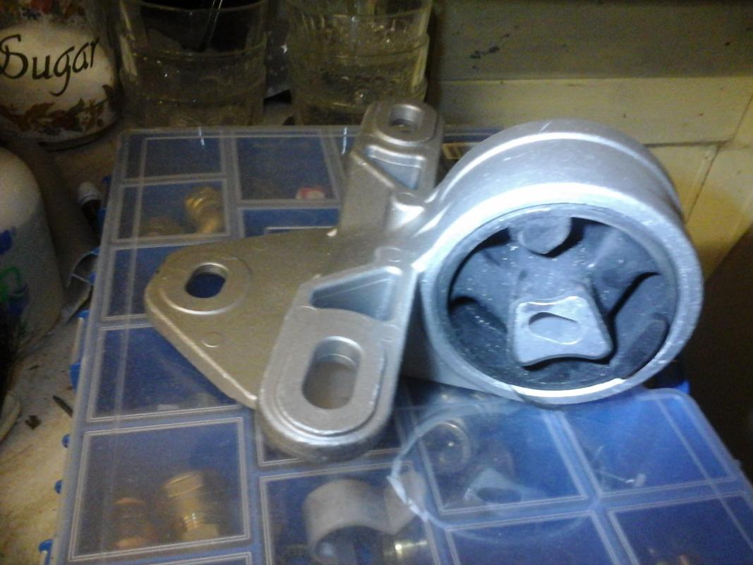

Old Sep 6, 2014 | 03:34 PM
Default Front Engine Mount.
I think matgriff is referring to this mount or more like a damper. The way its made it takes compression when engine goes back on head. Sorry to say that it is very flimsily made as its easily ripped apart on rebound stroke.
Mine has went again after renewal last year, I'm just wondering if the main mounts have seen better days.
One pic is old unit, other is new one.
Attached Thumbnails 2001 2.5 CRD engine mount-voyager-mount-1.jpg   2001 2.5 CRD engine mount-voyager-mount-2.jpg

Yes Goggs, that's the one....
As you can see there is no possibility for fitting it the wrong way, 90 degrees out or otherwise (unless of course you re-use the bracket & fit a new bush)
Old Sep 7, 2014 | 06:50 AM
I assumed [wrongly] that you just swapped out the bushing, not re-purchased the whole bracketry.
