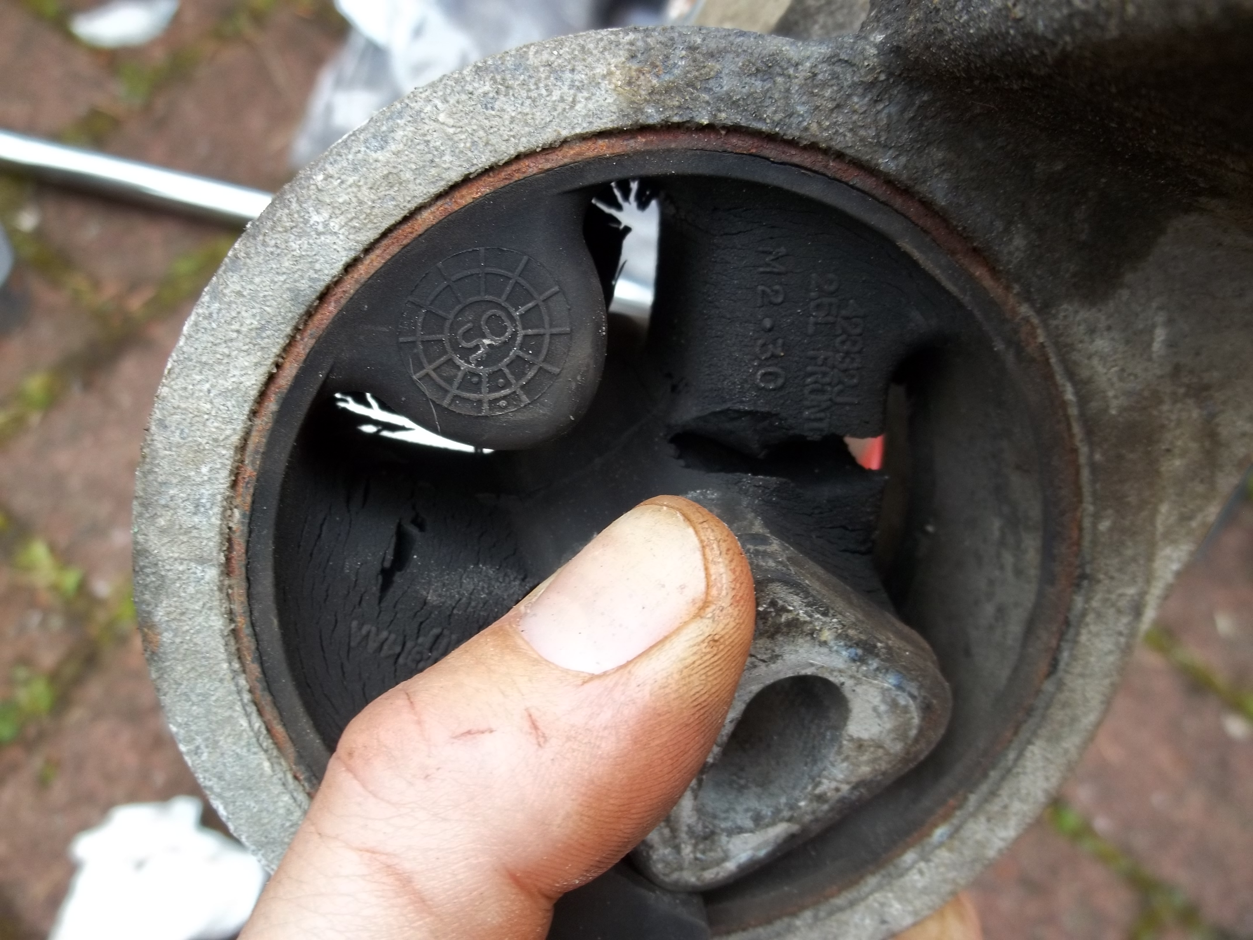

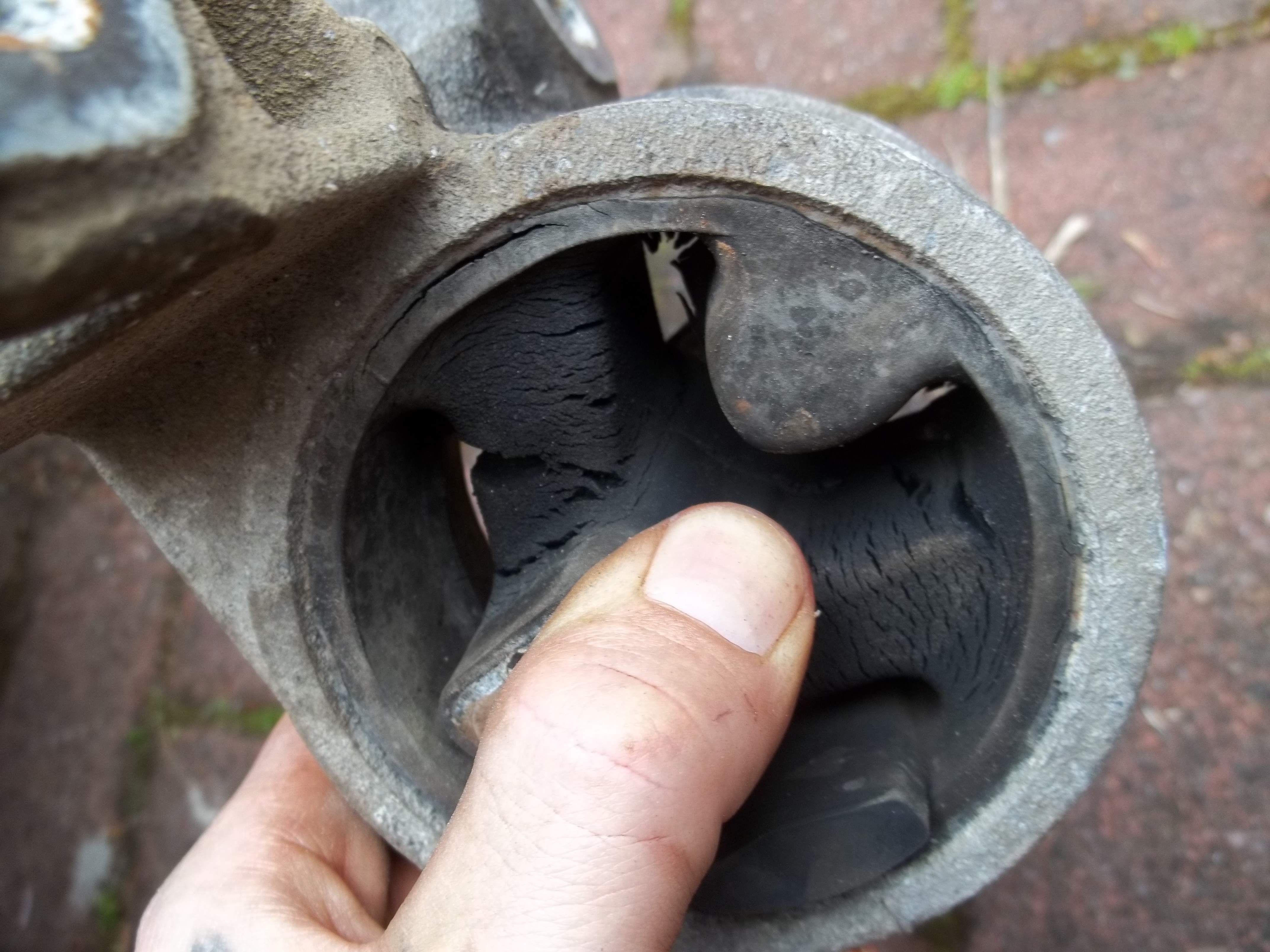

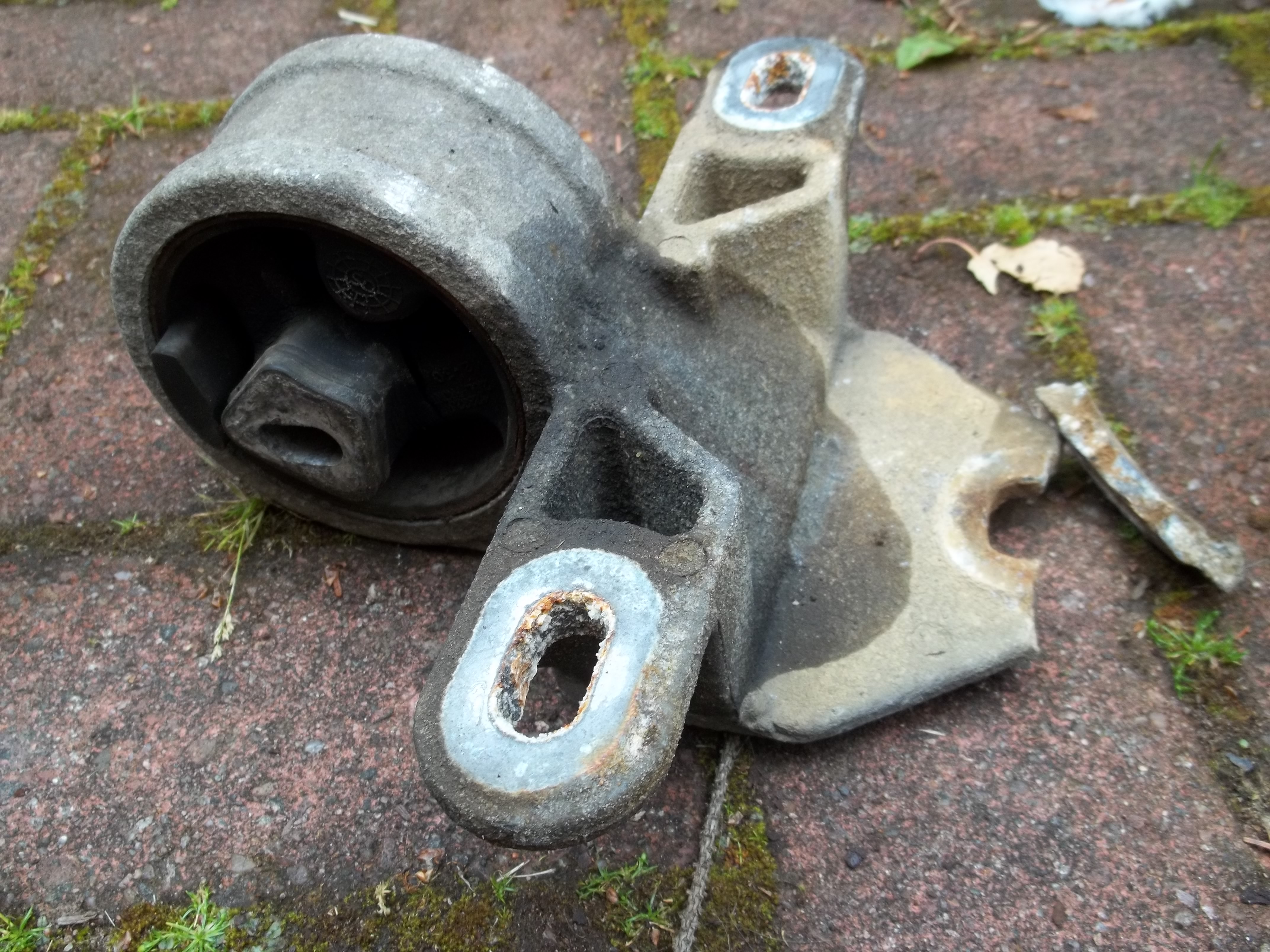

Got mine replaced today.

By the shape of the rubber inside and where mine is ripped I would be likely to fit the replacement insert upside down.
Did you consider this Imtattoo80.
Old Jun 16, 2015 | 03:11 PM
  #23
Or Matgrif with your insert.
