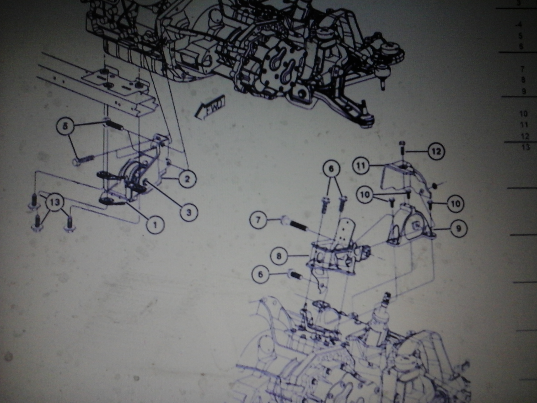

Default 2004 2.5CRD Engine mounts.
Here's what I've got for a 2004 2.5CRD with manual trans. I would think my 2003 engine would be much the same.
So there's a right side/cambelt side mount. Left side end of gearbox mount and a rear engine mount. Need to check on the last two here.
Also notice front mount which is called an Isolator.
Attached Thumbnails 2001 2.5 CRD engine mount-chrysler-voyager-mount-gearbox-1.jpg   2001 2.5 CRD engine mount-chrysler-voyager-mount-engine-right-side.jpg   2001 2.5 CRD engine mount-chrysler-voyager-engine-mount-rear-3.jpg

spoke to a Chrysler mechanic today and he confirmed to me that in 90% of the cases the front mount is bad and to be replaced (at least) every 100-150K km on 2.5 and 2.8 CRD engines.
Other mounts should be fine a lot longer.
