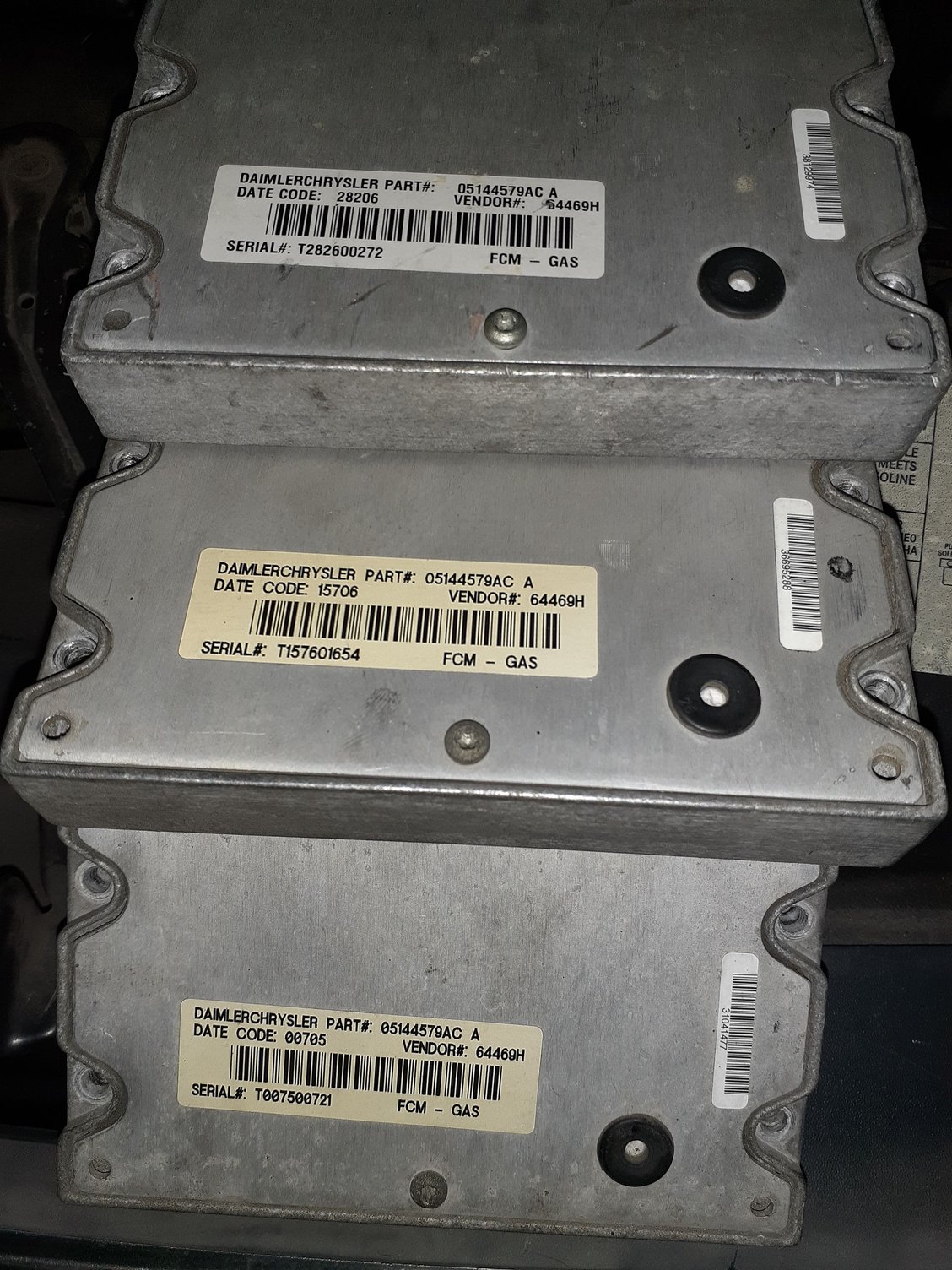

Ok i finally fixed my car. The fuel pump fuse was blown so it wouldn't start or let me connect to obd2 port.
As for the PCM, it's pretty bullet proof. It's just a pcb with tracings to connect the different connectors coming off of it. Only way it can go bad is a bad solder of connector pin on the board where it broke loose over time through vibration. You can take the PCM apart pretty easily & check. Only thing tricky is Chrysler cheaped out & had 4 loose pins that's not soldered to the board at all so putting out back together is a bit tricky. I used hot glue to glue pins to pcb which help keep them in position when i put them back together.
As for the FCM, they are interchangeable between cars (not programmed to specific car). I picked up 2 of them with the same part numbers but different manufacturing dates & they all work in my car.
I bought a PCM also but i haven't tried to plug it in to see if it'll start my car or not. I'll report back if i get around to testing it.
