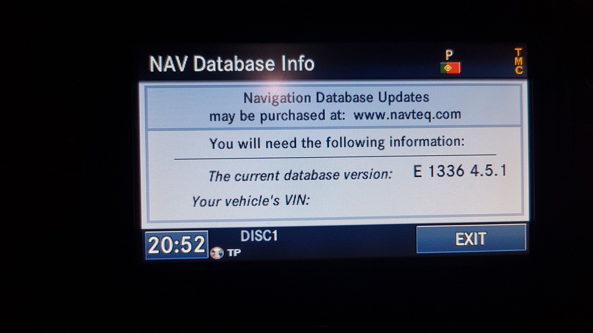

Regarding the radio, these is what I have. Can you please tell me my maps date?
Did, by chance, any of you ever managed to update your saved points from a garmin or any other GPS to the radio? It would be so much easier to use, as I have a ton of data to import to it...

You RHW has the latest firmware and the latest map update 2014/2015. Your Gracenote database is from a rhr (US) und not from a rhw (Europe)

Posts: 12
Again you came to the rescue. Thanks a lot. Maybe the gracenotes (or the map) are a hacked version... I didn't know the previous owner cause I bought it from a stand (unbranded)... either way, How come this is the latest version? I saw some with a garmin look alike display, which seemed more recent... you said it was 2014/5... didn't they keep on doing more recent versions?

2014/2015 is the latest version for europe. What you mean with Garmin look is not the RHW. This is the RHB430N from Mitsubishi which never sold in europe
