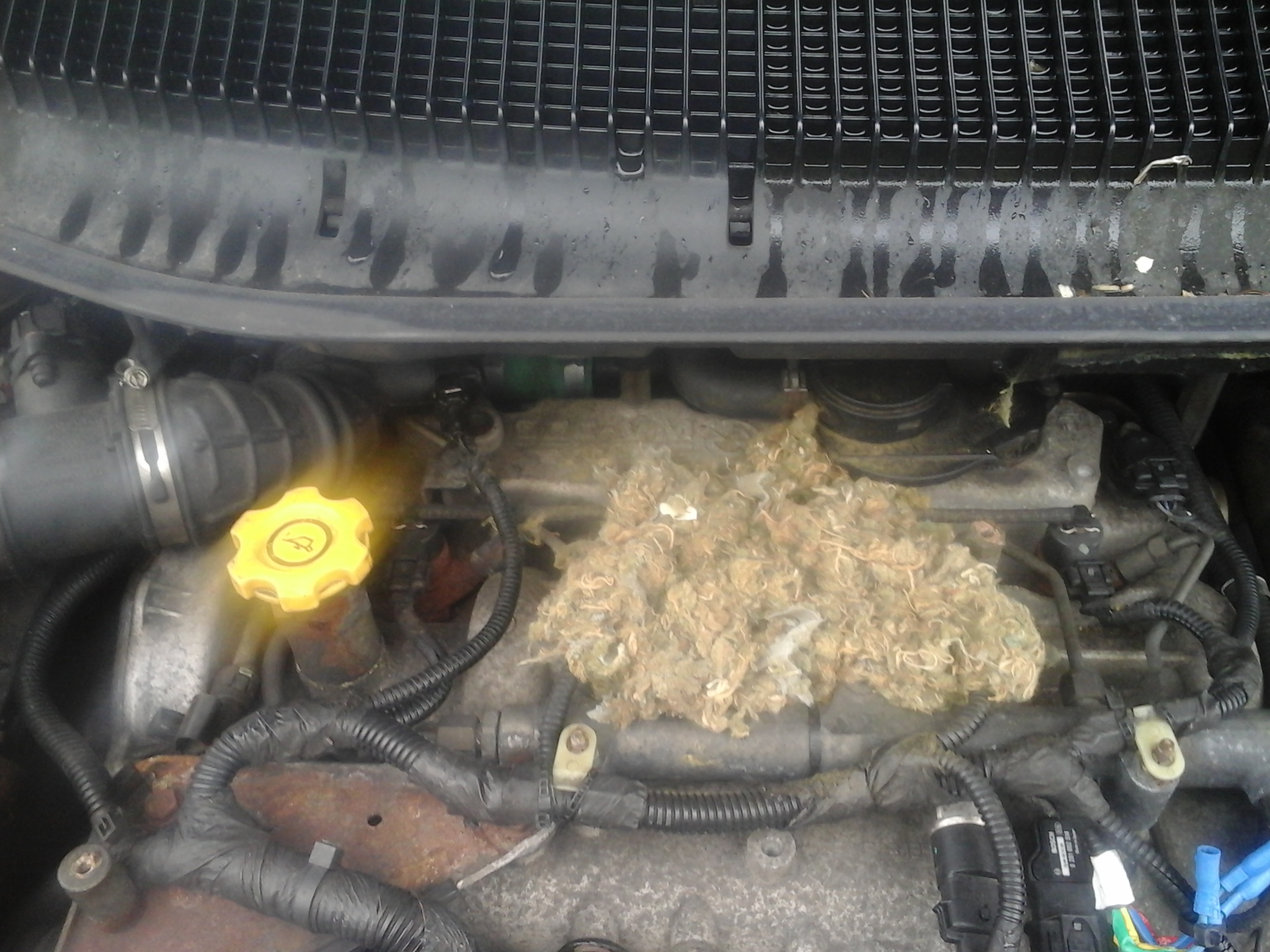

Having a looksee today but rain temp stops play. Right the top pipe on the valve goes to the bulkhead which is actually the Vacuum brake assist reservoir tank. The other pipe must go to the EGR. I however found a problem on mine where the pipe coming from the tank is kinked even though there is a rubber elbow joint at it. Too short a pipe is causing this. So my EGR is as you would say isolated. Battery requires removal to gain access to this area.
Oh and I found mice nest under the engine cover...
Ok, smallbore pipe is 3.69mm and my kinked elbow is getting Vacuum through it but looks damaged.
Thanks Goggs.
Mice nest They must jump off the car before a journey otherwise the temp in engine bay would cook them alive
