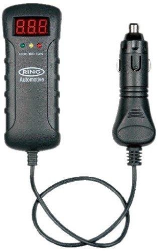

The little Ring meter has been in the LHS lighter socket for a year and normally reads @13.9v [ish]. The two wires are also blue & brown [like Leedsman's] The battery is a fully charged S5 800CCA. Brown was checked with probe then read @ 3.7v with the Fluke [Leedsman said around 5v]. The 0.6W resistor was chokkied into place and my Ring gave a nice steady read of ................. 14.0v. So I did the test and got totally different figures. - where are you Leedsman ?
QinteQ can that red thing be used to test for an electrical feed. I need to test wires to see which one is the one for reverse or is there a better tool for the job

Anyway, darkcild101 is it just to find which lead at the back/light cluster or elsewhere?
I can probably check my rear light cluster and tell you the wire colour if you're stuck?
But yes that red probe tester QinteQ has would let you, you put the wire/clip onto the chassis and can probe for positive voltage. Same with a multimeter if you have one. To be honest if you're going to invest in something, get a cheapy multimeter and then you have a few toys in one box rather than a single unit that can't do a great deal (Multimeter will give you battery voltage too, as seen in the earlier discussion about the charge voltage, etc)

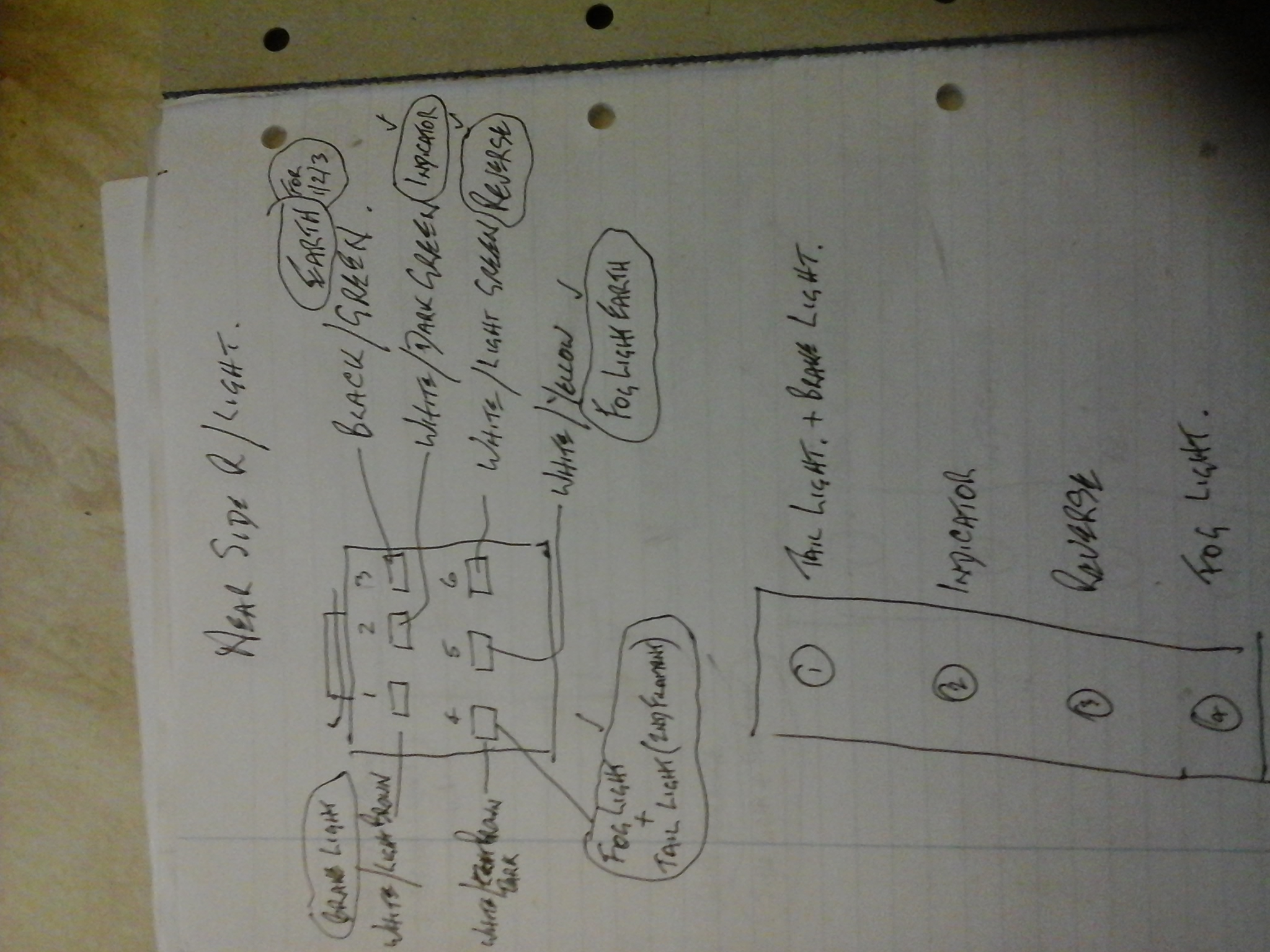

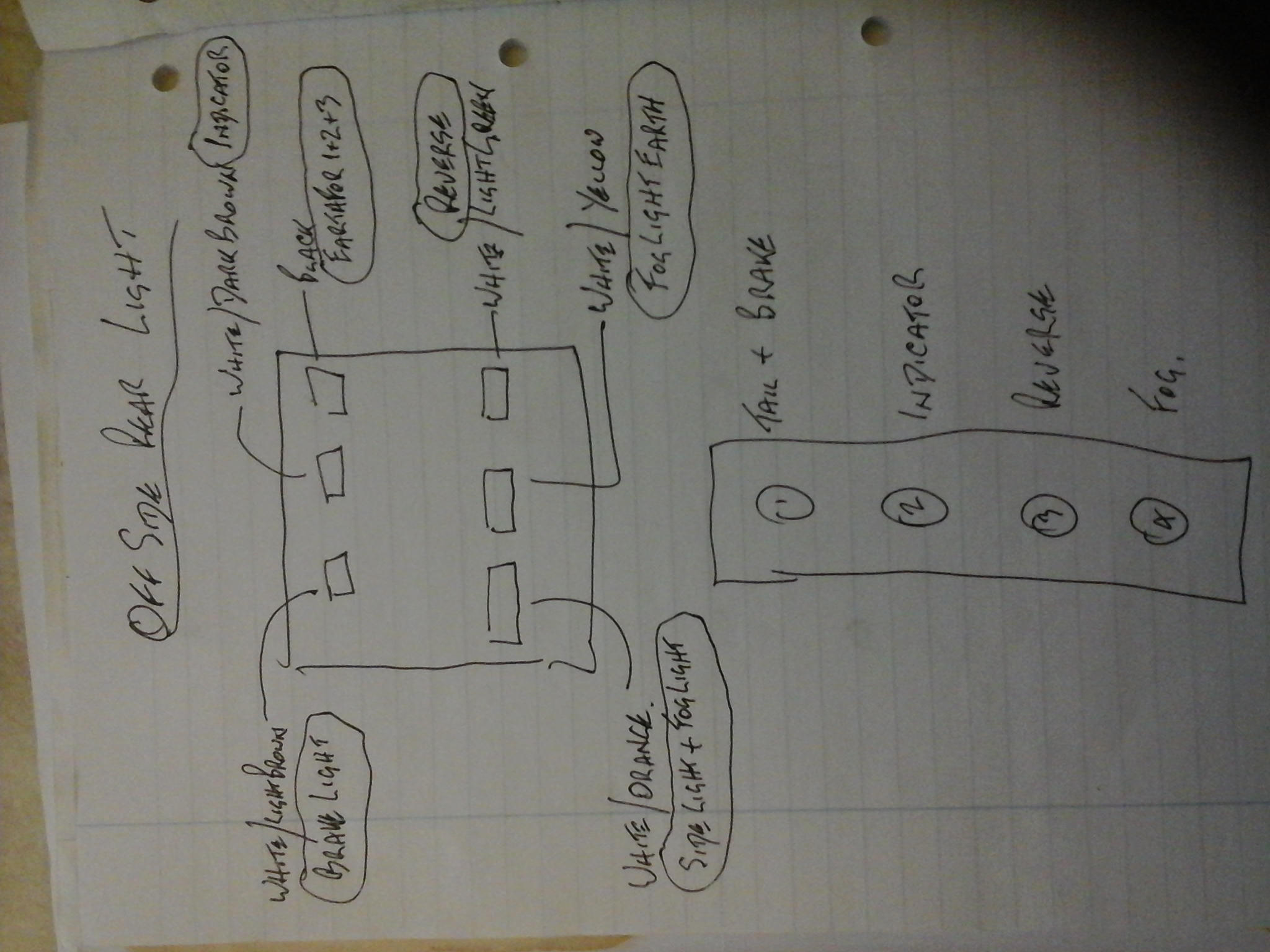

Darkcild here's my 2003 Voyagers rear lighting wires which might be same as yours. Still as drawings but you can see what's what. One pic's Offside. Other is Nearside. As you can see there is an odd earthing arrangement which I worked out but it eludes me at mo.
