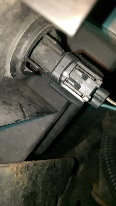

Right, onto the battery temperature modification. I spent a little time this weekend whilst changing the glow plugs and did a few tests.
Looking under the battery tray (Using the camera to take a pic and work out how to get at it!)
Taking the battery completely out and pushing the clips in it comes out upover, so I removed the sensor completely to take a look.
As I suspected it's a simple thermistor where the resistance is HIGH when cold and LOW when hot.

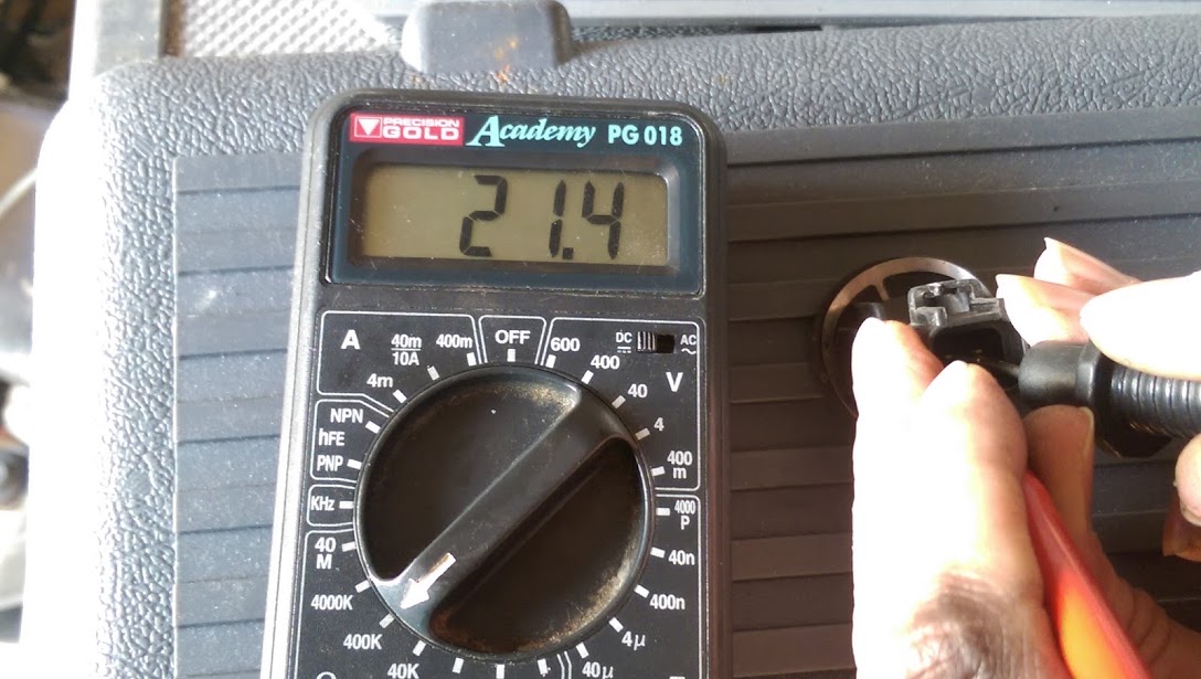

At cold ambient temperature (I'd reckon it was around 6oC)
So resistance was at 21/22k ohm.

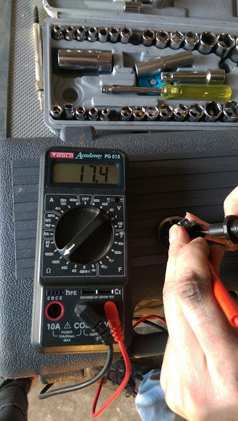

I then heated the sensor up and the resistance dropped:
down to 17.4k ohm. So we now know a definite change to the resistance.

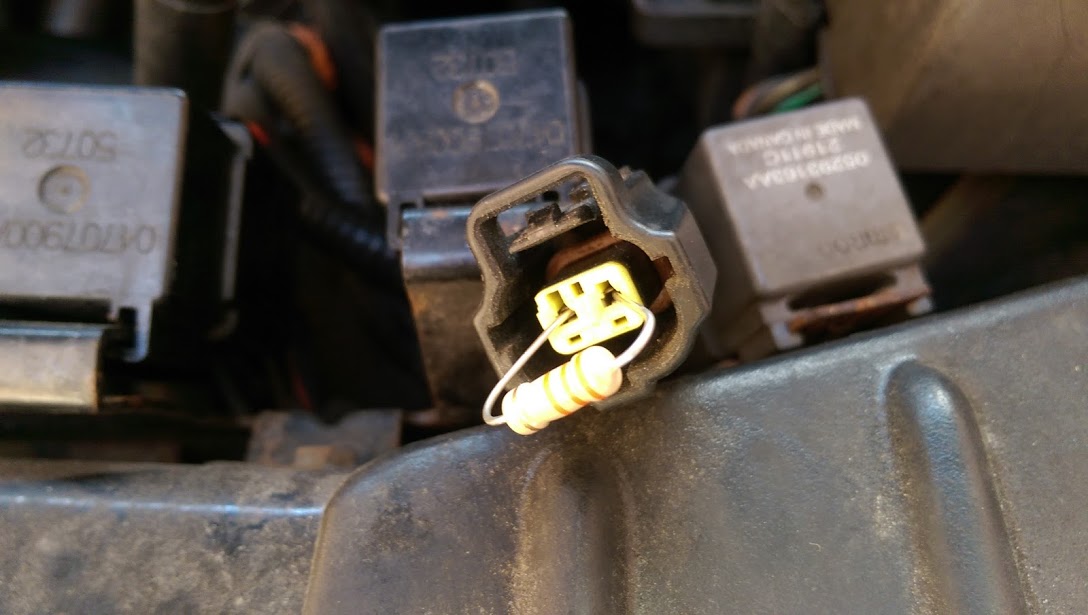

Going back to Leedsman's original idea of a 33k resistor, I reckon that is reasonable as that'll assume colder than 6oC and force it into full output from the alternator.
So I simply pushed the resistor into the connector:
That was a 33k ohm 1watt resistor (It probably could be less wattage, that is just being safe really as it's only signalling voltage needed).
So my testing results (engine running, minimal drain, no radio, no heaters, etc):
  • No modification (stock), engine cold, outdoor around 6oC: 14.3volts
  • No modification (stock), engine hot, and heated the sensor: 14.1volts
  • 33k resistor in place: 14.4v
So although I wasn't getting much variance between hot and cold with the stock sensor, having the 33k resistor in place seems to give the top results.
I've removed the mod again and going to test the voltage periodically over the next few days driving, see what the change is actually, to work out if this mod is even worthwhile as at the moment I'm sceptical that it's needed unless you live in a REALLY hot country. Here in the UK I'm starting to think the temperature on the sensor is never going to get hot enough to reduce the charge sufficiently to be noticeable.
