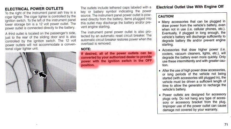

As standard, the Voyager models leave the factory with the right hand cigarette lighter powered via the ignition and the left hand cigarette lighter powered via the battery, i.e. live all the time.
However, an option exists to also have the right hand cigarette lighter powered via the battery simply by pulling the fuse and replacing it in the next position in the fuse box. Refer to your drivers handbook for the details. (or search this forum)

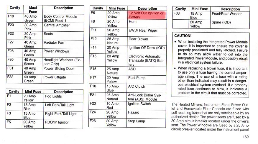

O.K., I just braved the rain and scanned a couple of pages from my drivers handbook.
Page 71 explains that ALL the outlets can be converted to provide power with the ignition off. It says the work can be done by your authorised dealer but it's just a matter of pulling fuse F6 and inserting it into the next position. (I think this is marked on the lid of the fuse box)
