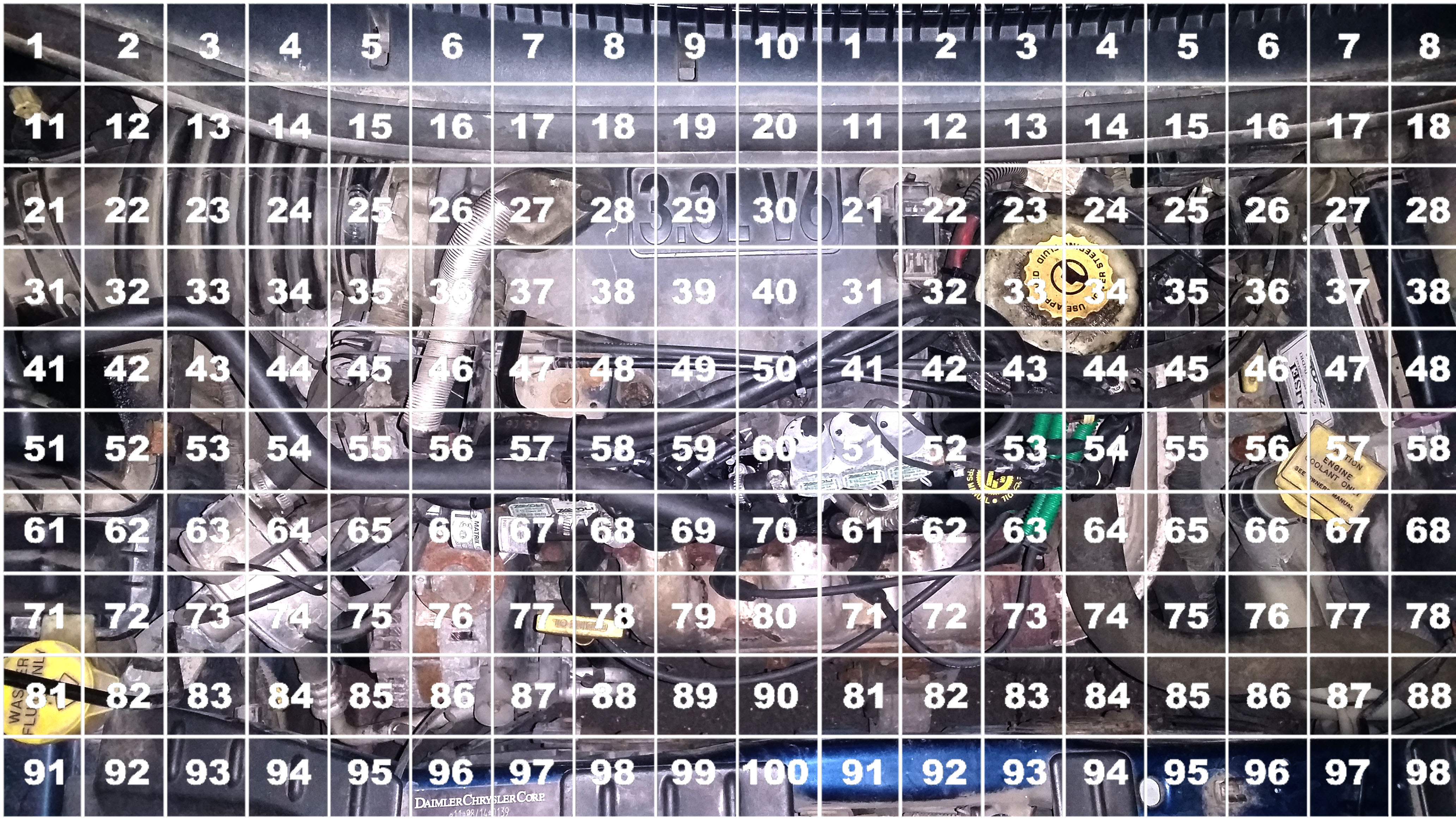

Question
Two? These are all?
2 "NGK 6384"?
Could you give me the approximate place?
See Appendix (number and "left" or "right").
Attached Thumbnails Chrysler Grand Voyager IV 3.3 Limited (12/2000): "P0171 System Too Lean Bank"-daimler-chrysler-voyager-3.3-v6-engine.jpg
Old Mar 12, 2017 | 04:46 PM
svenne's Avatar
Joined: Jun 2016
Posts: 8
On my 2002 grand voyager 3.3 awd the first one is on the exhaust manifoild and the other on the catmuffler. Could be the fuel filter to. Bad filter can also give you this code. I changed the filter and replaced all fuelinjectors also. The engine performed better after this and got better MPG too.
