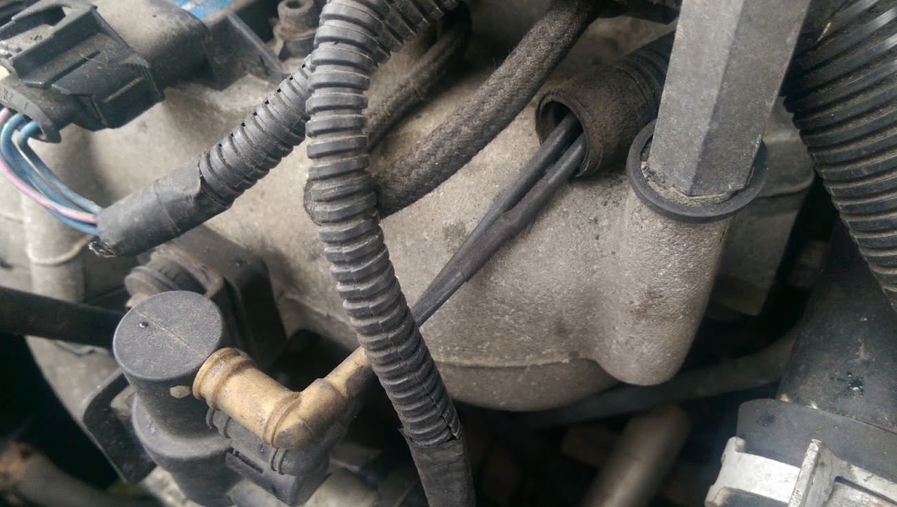

Having taken off the EGR valve, cleaned it and refitted I seem to have a
vacuum connection left over with no visible pipe to fit to it.
I know I should have taken a photo before taking it off but ....................
Anyway I've attached a pic of what I have now.
Does anyone have a plumbing diagram or photo so I can what's wrong.
Thanks
John

Hi there,
I've had to do a little fix to one of these two pipes so I know the upper one goes backwards and round to the right of the engine bay. The other goes to the left. My guess is it's gone back inside the trunking.
Here is a pic of the valve on mine and where the pipes go back to initially, hopefully you'll spot them. If not I can probably take a more in-depth photo later of where they end up with a bit of rummaging around!
Hope that helps!

Looked at mines, the pipe you've got on the 3rd one down is for the second one down, that you're missing.
The 3rd one down on mines is blanked off, same as the one in Andys picture.

Thanks
I'll swap them over tomorrow and see it that's it
