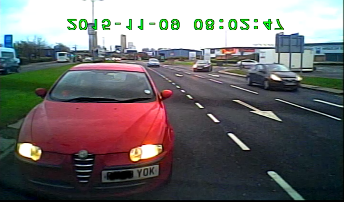

I grabbed a screenshot from my drive into work this morning from the rear camera which helps show what it can see.
I've got it positioned up as using it as a dashcam/recorder rather than parking aid, but the view is pretty decent out the rear window. This grab is from sitting in traffic, so the car behind at usual distance.
If you're interested I'll try and angle it down to view my bumper and see what I can get, to help for parking+towbar connecting?
(BTW as you'll see the attachment is upside down, an annoying problem since I move the mirror for right-hand-drive!)
